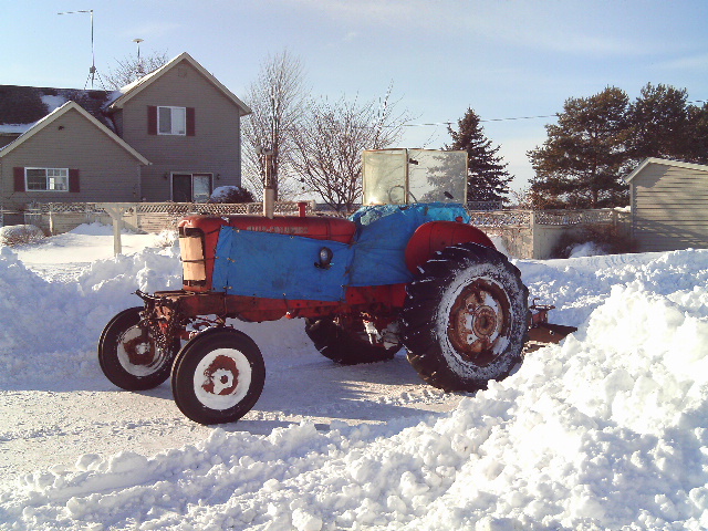

The old fashioned way:

Post Options Post Options   Thanks (0) Thanks(0)   Quote AC WD45 Quote  Post ReplyReply Direct Link To This Post Posted: 03 Feb 2011 at 12:25am
Note the card board LOL
