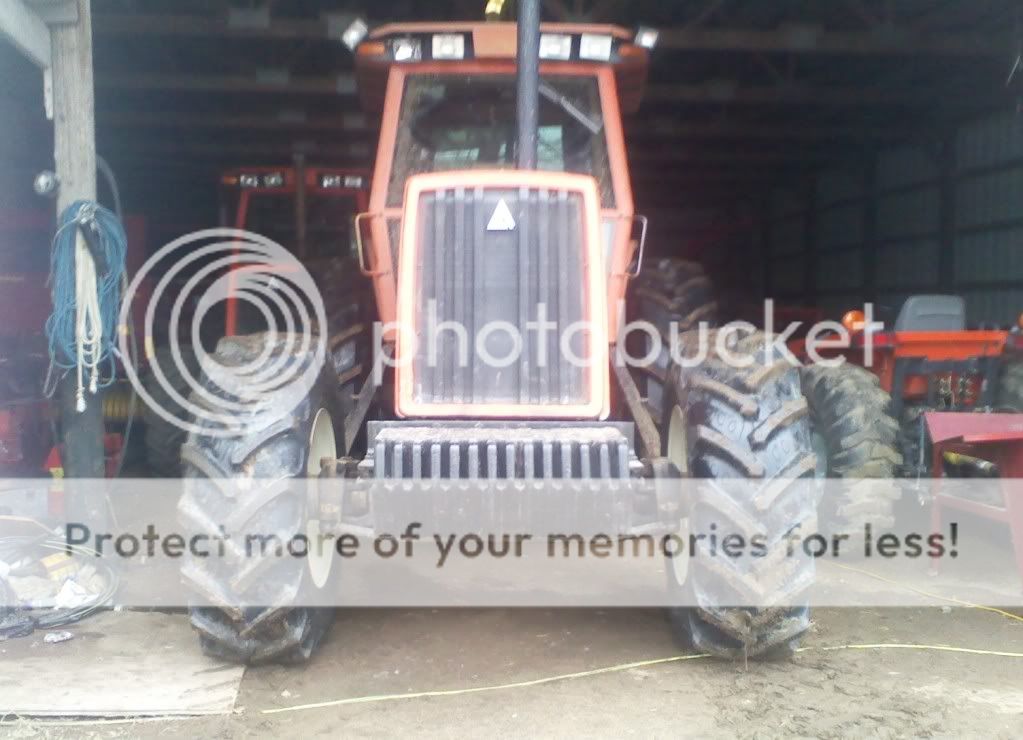

Saved this one two years ago at the local auction. only payed 15,500 for it. had the oversized front tires on the front. 20.8x38's on it and 18.4x26. now its got 20.8r42 on step rims and goin to have 16.9r28's on the front in acouple weeks.

o and yes i moved the front axle and weight bracket up also.

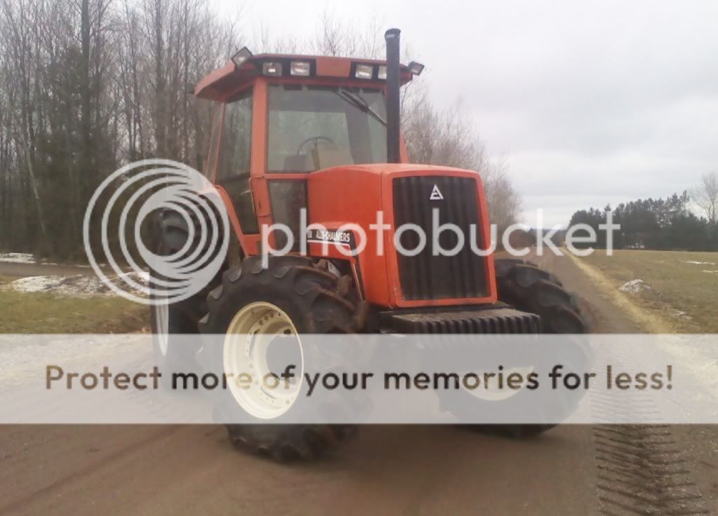

i found a pic of what it looked like first.

It looks a lot better with the front axle moved forward. I think these tractors were ahead of their time. Wasn't it several years before the other companies moved the seat ahead of the rear axle.JP

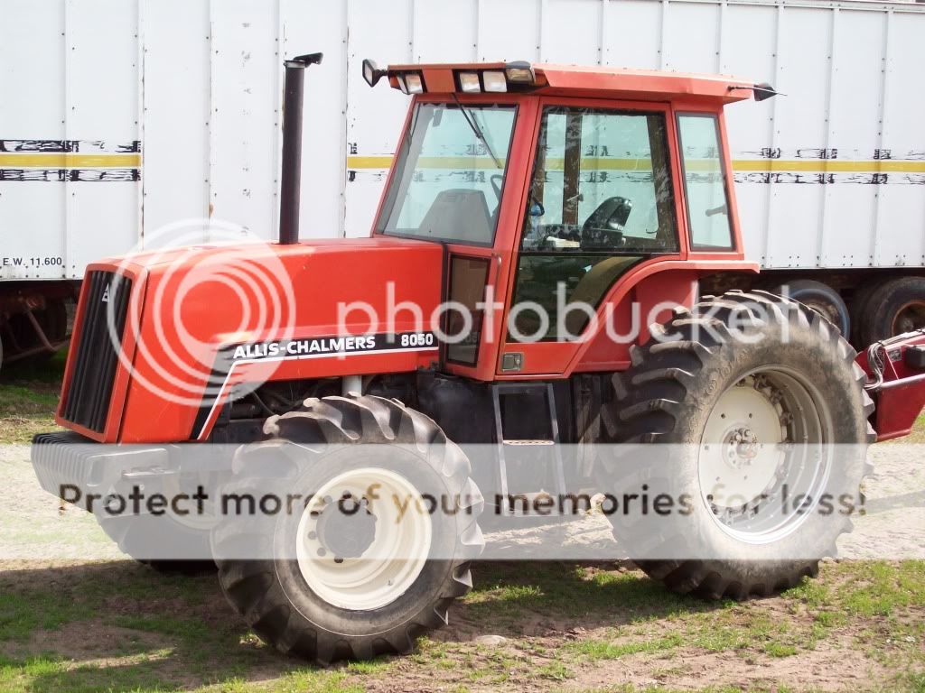

i had to cut the rear hanger for the 2wd axle off. then just moved to rear most holes to where the front holes were, and then redrilled for the front bolts. i then had the driveshaft extended at a local machine shop. he also made the tube out of heavier material.

yes powershift. and it had alittle over 5000 on it. the reason that i did it is because it should ride alittle better and also should go threw more.
