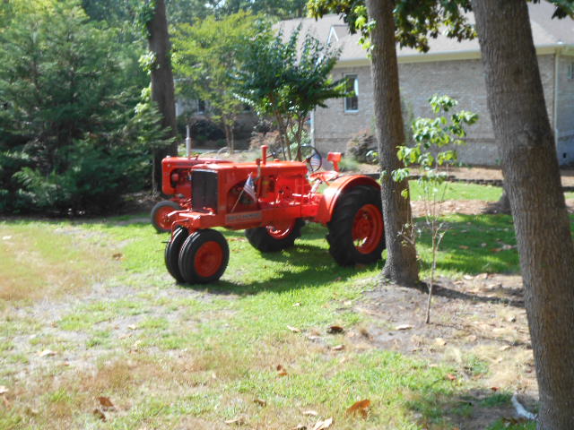

I run Ethanol free gas in my 37 WC. No problems. I always shut off the fuel and drain the carb when not in use.
