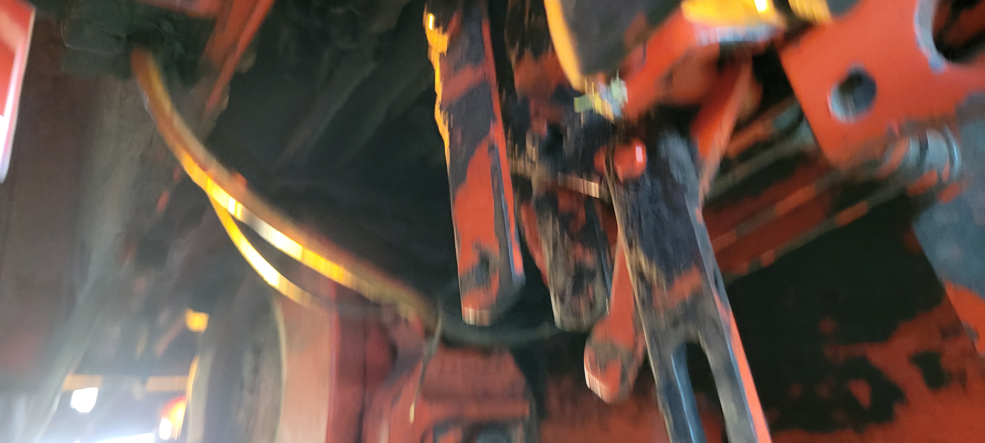

Got my new 190XT.
I noticed position control wasnt quite working right, and this linkage is not connected up. I can't seem to figure out what I'm missing and how it all goes together from the parts manual. Anybody got a picture of theirs?
I just realized the picture isn't very good. It's right behind the valve stack and looks connected to the outboard most valve.
Parts book calls it the sensing lever and slotted link.

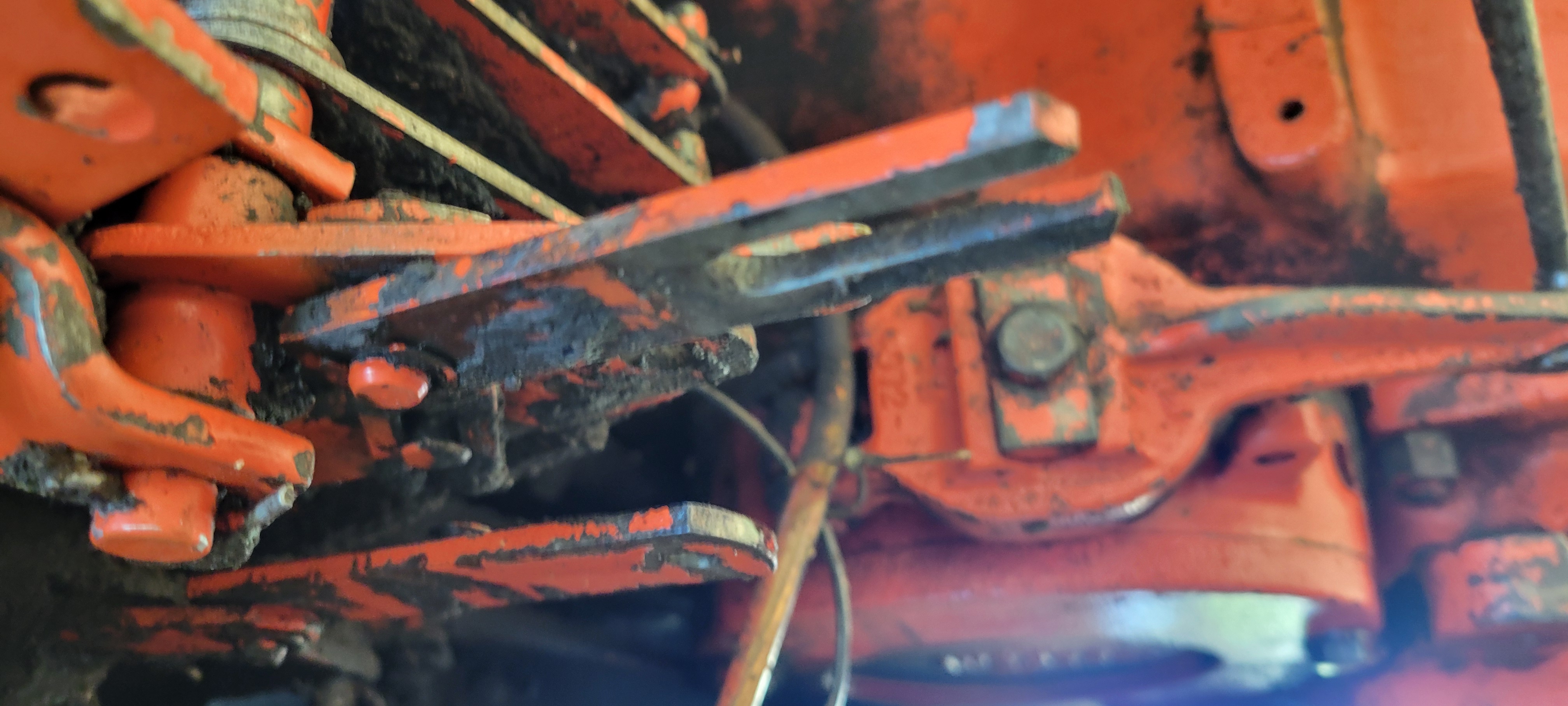

Post Options Post Options   Thanks (0) Thanks(0)   Quote MadCow Quote  Post ReplyReply Direct Link To This Post Posted: 25 Sep 2025 at 6:41pm

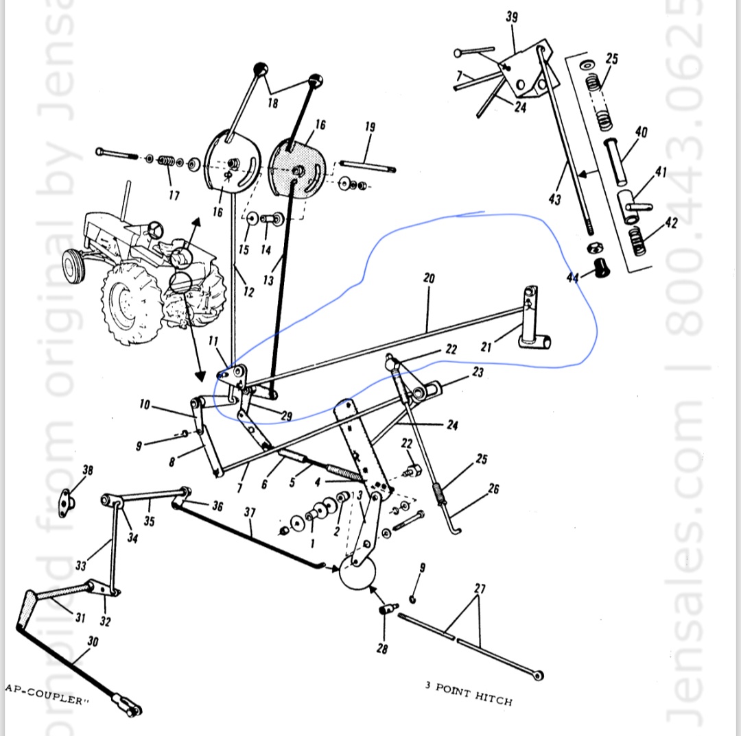

A better picture of the linkage. I believe it's the item 20 from this page of the parts manual. But I'm not sure how it links up. Would someone be willing to take a picture of their 190. Right side directly behind the valve stack.

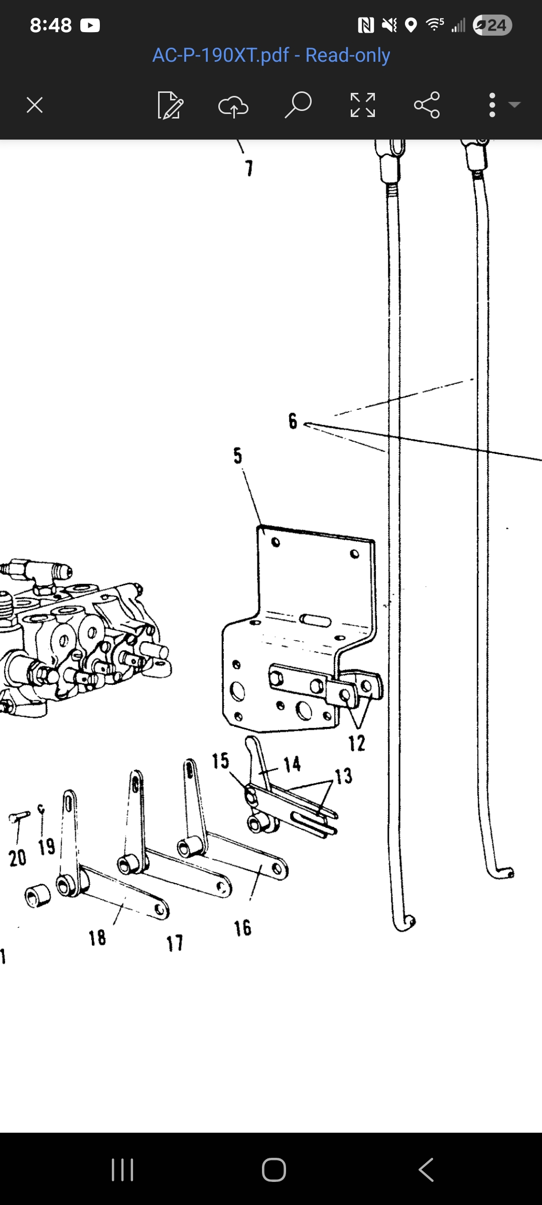

Would either of you be able or willing to take a picture of your tractor at this location? I'm not sure I'm even looking at the right page of the parts manual

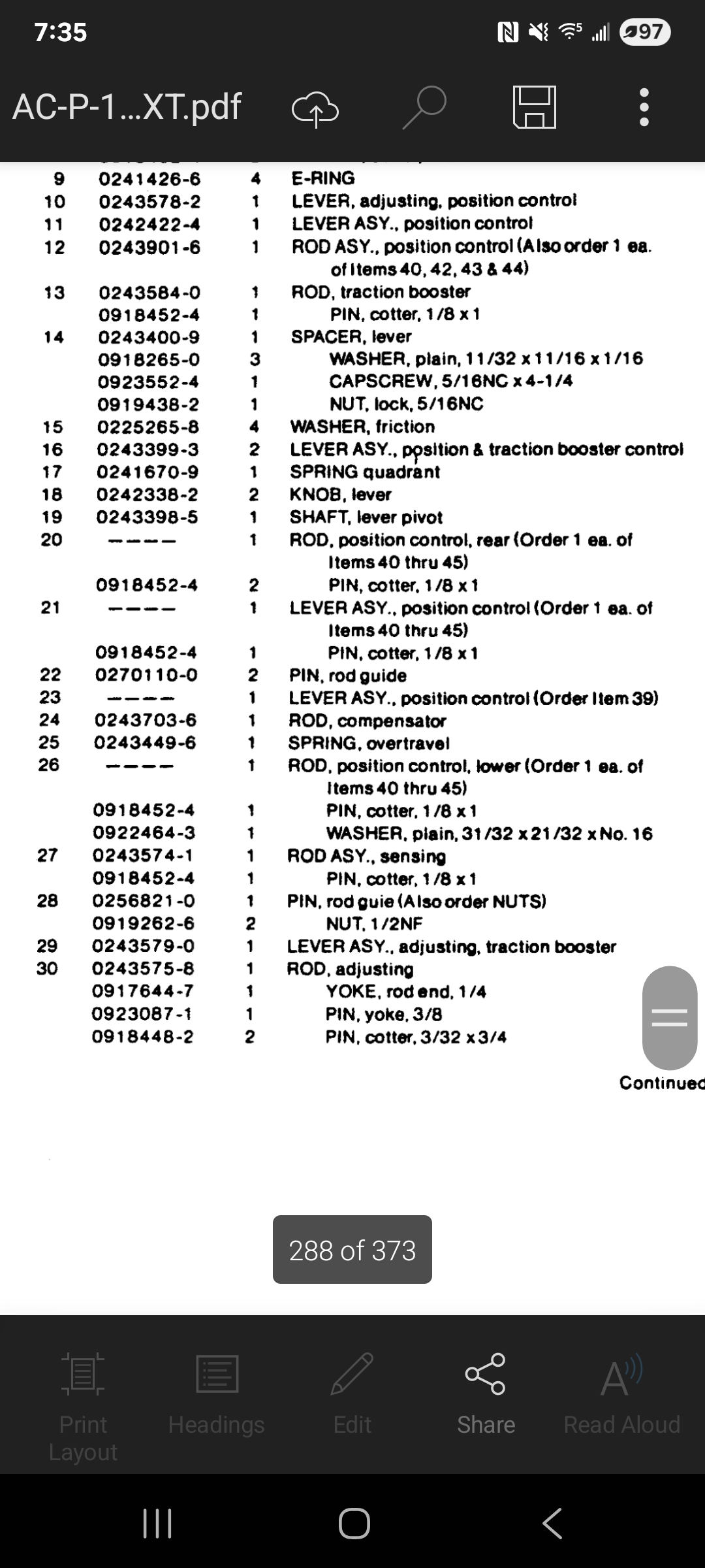

I know the disconnected linkage is part 13,14,15. But what does that connect you to on the other page? Is it #20?
#20 is an assembly of 5 parts. It says to order parts 40-45, but there is no part 45.

Rod 20 and 26 have different labels. But the same description telling me to order parts 40-45?! There's no part 45? 20 and 26 point to different locations.
I'm so confused. Maybe I can call a salvage yard and have them piece together what I'm missing.
