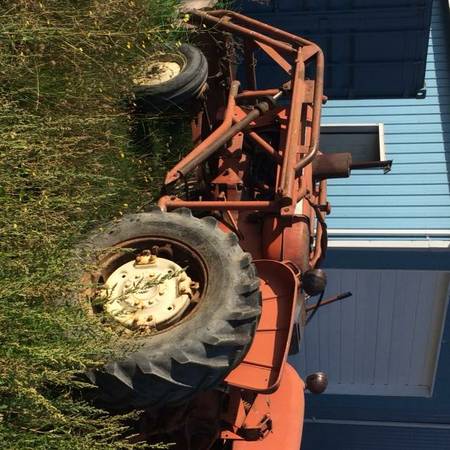

Looking at a  64 D15 Series 2, nice shape, kept inside, 4200 hours, loader, factory 3 point, all gauges work,  rear tires are crackedand not better than 50% left.  I already have a D15 S2 but the factory 3 point has me thinking.  Can rotate the picture on the computer, and save it but when I upload it puts it back to vertical.   Hmmmm.

I think oval muffler and lights on the fenders makes it a Ser. III
Check tractor Serial No. and see if it is above 65001.

There is no Series III D 15. That only applied to the D 17's.

Around here, at least $2500 at auction. with better rear tires, more $

Friend who stored his tractor at my place sold one a year ago for $3500 cdn. I was a nice original 1966 D-15 II 3 pt. good tires  no loader.

If it runs good! 3K all day!

Thanks everyone.   I paid $3500 Canadian for the one I have in the barn, and a couple hundred more for the snap coupler blade.   This one has the loader and 3 point, wondered what that would do to the price.  It is a long way away.  Have to go that way late November, so if still available may swing by and try to make a deal.  May need special permission from "she who must be obeyed" to do any more than drool.

Good running D-15 Ser II around here that doesn't jump out of gear and power director is in good shape bring 4 - 5 thousand all day long. Even more if I start bidding on them. Tires hurt value , but if rims are in good shape they can be upgraded easily enough . I paid 4 g for my D-15 Ser II fct 3 pt without loader and tires were in similar shape . I have been very happy with mine .

Not a penny over $3000.  That loader is not worth anything.  IF it was a fully hydraulic 400 loader, it would be worth much more.
Looks to be a nice tractor.  Factory 3 point is nice, but can't do much with it - it's rather flimsy for a 46 hp tractor.

Sorry Dseries but I totally disagree, that’s not a flimsy tractor. 46 hp with loads of torque. Dad’s 1968 D-15 has that exact setup. I will agree the trip loader isn’t the best, but it does lift quite a bit of weight. The loader does have its limitations, but with the loader off the frame makes a great protector of the rest of the front end, surrounded by that tubular steel. As far as he tractor, the factory 3 point does a good job with 3-18 Oliver plow. That little tractor handled 150 acres of corn, hay, barley, wheat, and rye for many years until dad bought a new 6060 in 1981. All crop 66, 10 ft Oliver disk, corn picker, plow, planter, drill, it did it all. One of the best AC tractors built in my opinion. Still running strong today. Looks like a nice origional, $3,500-$4,500 all day long. Loader doesn’t add much value.

The oval muffler is correct and series II was the last they made.

One more thing I forgot to mention is that the Power director jumps out of high when pushed hard according to the currrent owner.  I think it has to be split to work on it, so that is also a factor in pricing.  I am not familiar with the 3 point setup on the D15, have a 170 with which is Cat II and plenty heavy enough for the power of the tractor.  As long as 3 point matches the tractor should be OK, I would assume.

.. the PD on 'Troy'  D-14 #1 did the jump out too. I seem to recall moving some washers(spacers) at the bottom of the 'big handle' and it's been fine ever since. I also took off the parts connected to the Snap Coupler area that would automatically move the PD to neutral.

The factory three point on a D15 was one of Allis' weaker designs made. They nice and all but how they attach to the tractor could cause some serious problems. I can get you some pictures of a result of a D15 factory three point failure.
Every D15 I have ever bought came with factory three point on them. Switched out every one to snap coupler.

Power director will not be a major problem.  You only need to remove a washer or 2 from one bolt.  Done that with several tractors.  Don't rule out the 3 point yet.  It depends what you are planning to do with it.

Be careful to be sure and keep those 4 bolts into the bottom of the tractor tight. If the get loos the threads will pull out and the whole 3pt will drop on the ground. Allis really didn't have a usable 3pt until the D17 IV.

The rear tires are loaded.  If leaking you will new rims, tubes a,d tires if those ones are shot.  They are 26" which are costly.  You can put 28" on it and save a little.
It's a loader tractor!  You gotta figure it's been beat.  I would think the trans will or does have problems.  Probably original Rad so that will no doubt need attention.
It probably has P/S which is really nice!.  If it runs good, with the money you'll need to put into it I'm thinking 2000 - 2500.
