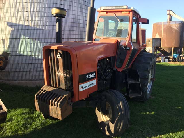

Today I replaced the oil cooler, door latch & got the LED lights working on the 7045.

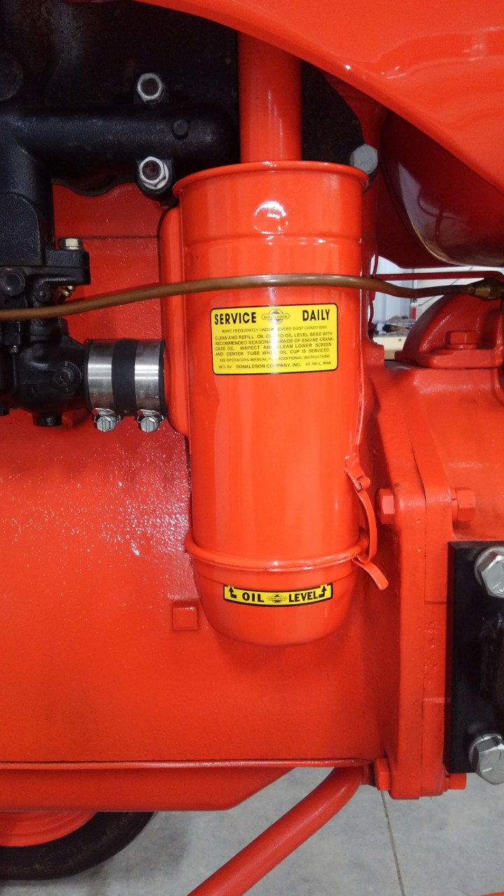

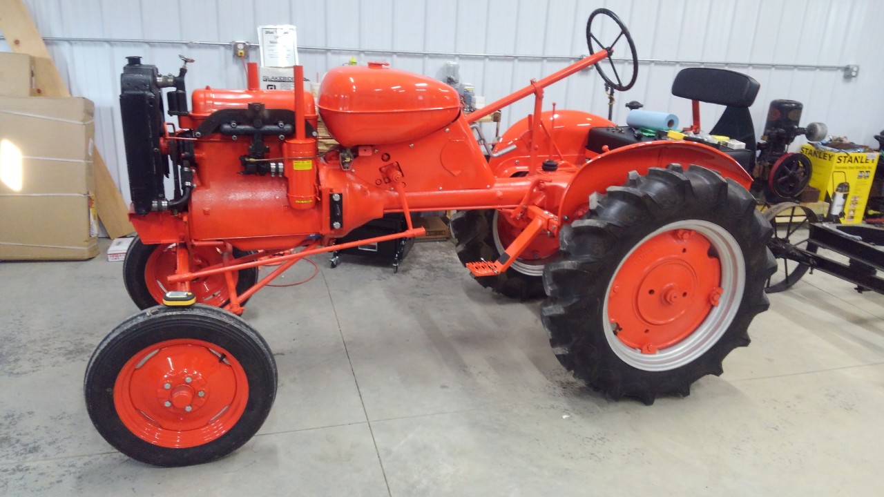

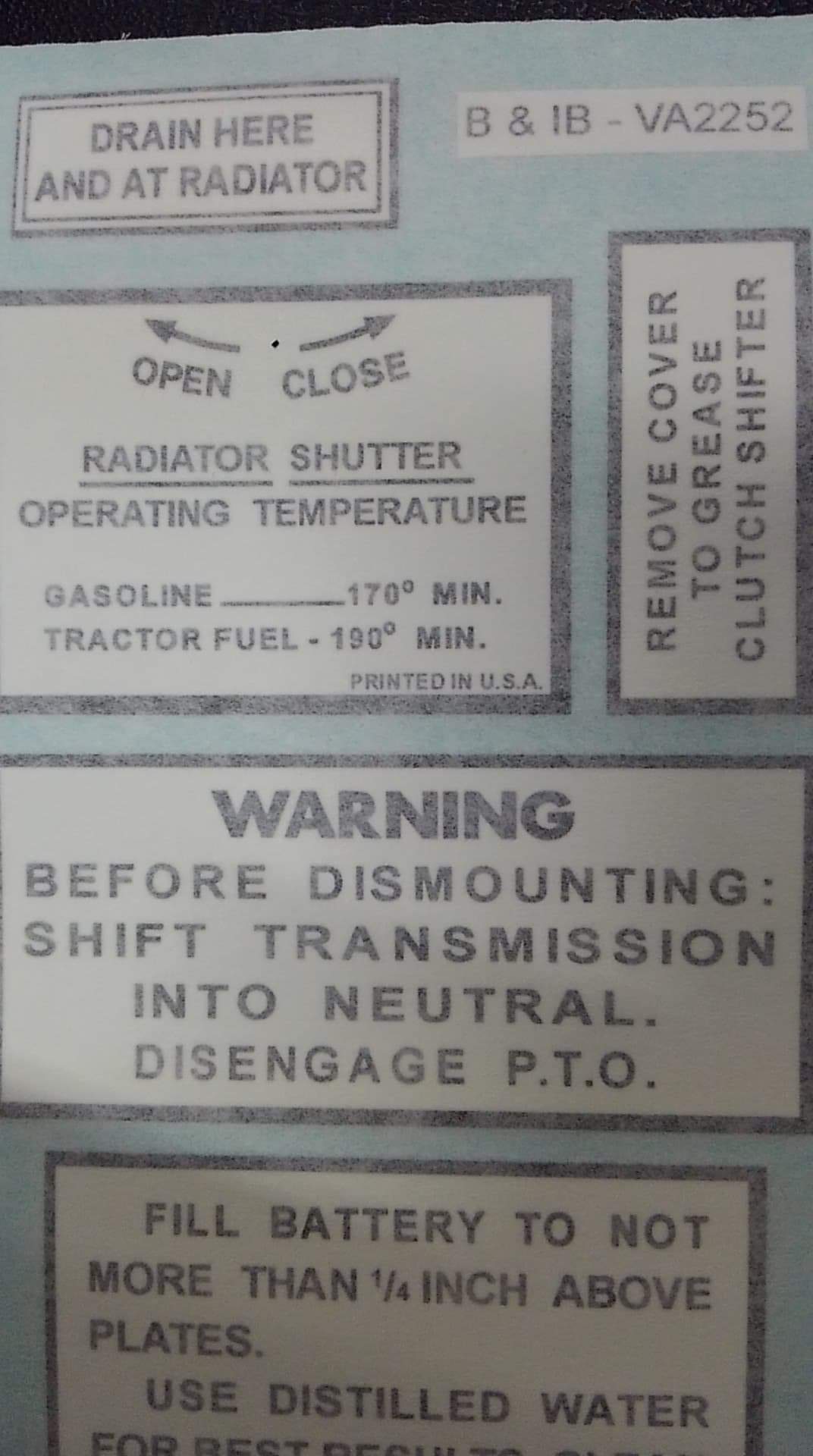

Changed out the late model black B decals for the early model blue decals and added the air filter decals. Looks a lot better. Had an engine miss, found it was crappy plug wires. Replaced them with a reproduction set from the Brillman Co, runs a lot better now (looks better to).
Have two decals not sure if they are used, and if so where they go. One is the dismount warning and the other is the clutch shifter grease plate removal. Any ideas? It is a 1939 B.

Tgtack, your oil level sticker is about 1/2 inch too high. Arrows should point to the ridge, just below where your sticker is.

Oops guess someone else has theirs wrong as well, went off a picture on the net. Thought was odd location. Will have to get another sticker. Thanks for letting me know.

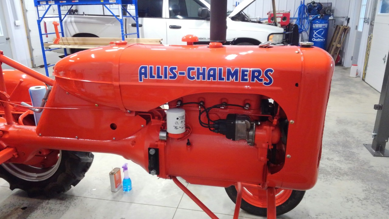

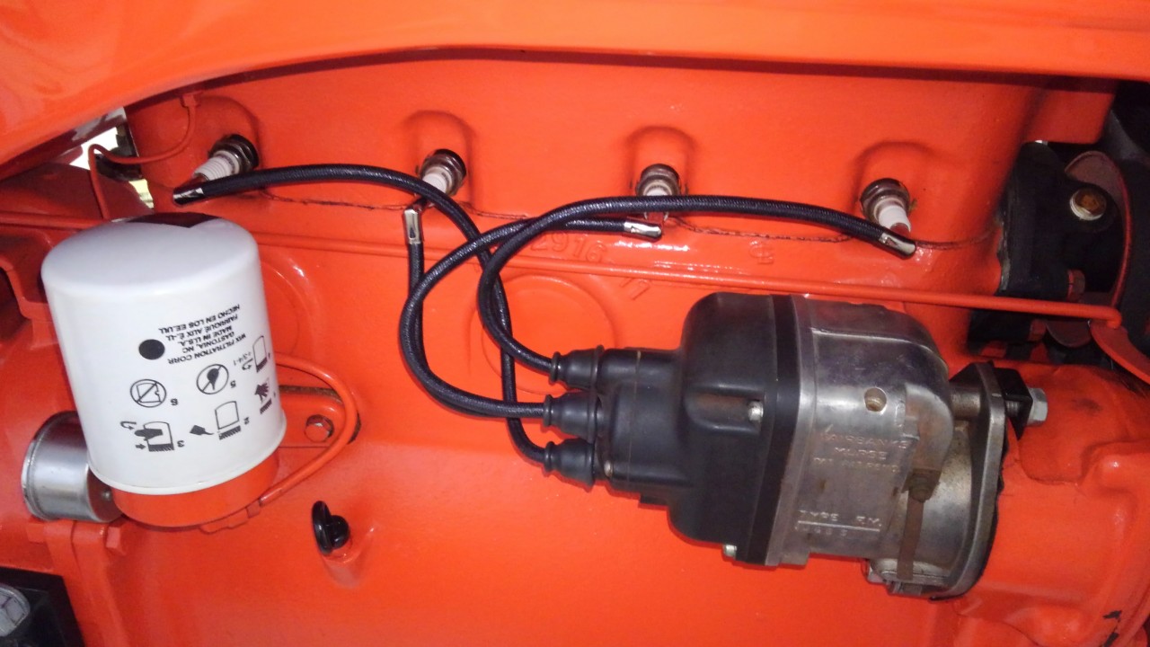

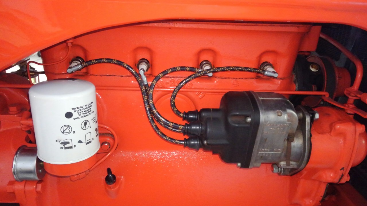

Made myself a new set of plug wires, used black with orange cross hatch and the 90* close connect plug terminals, installed my side step and added anti skid on top of the axle, and moved the air filter oil fill decal to the correct location.

That looks really good!

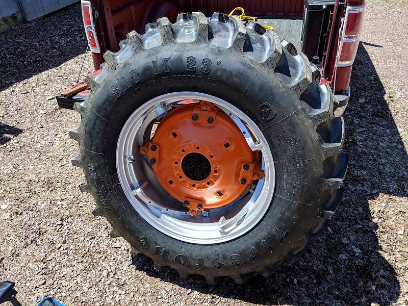

I cleaned up and painted the All-Crop rims and mounted new tires.

Those tires an rims look nice

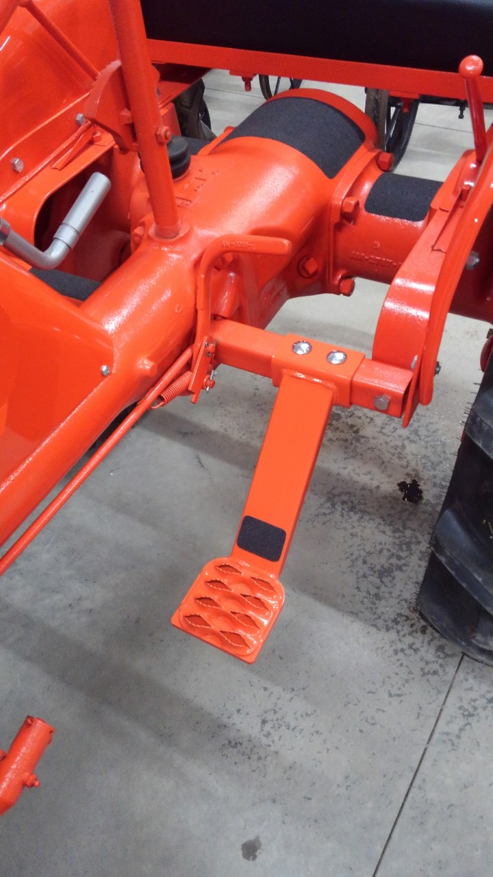

Pulled the tin work to do some cleaning and touch-up, straighten the grill mesh and put webbing between the joints.

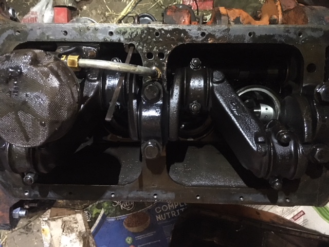

Ran the Cylinder hone and cleaned up some after.
Got motivated and decided to go and drop the oil and pan and get my first look at the bottom end. Now to order pan gasket and front rear seals which were badly needed ! Probably go ahead and replace that pickup and screen as well

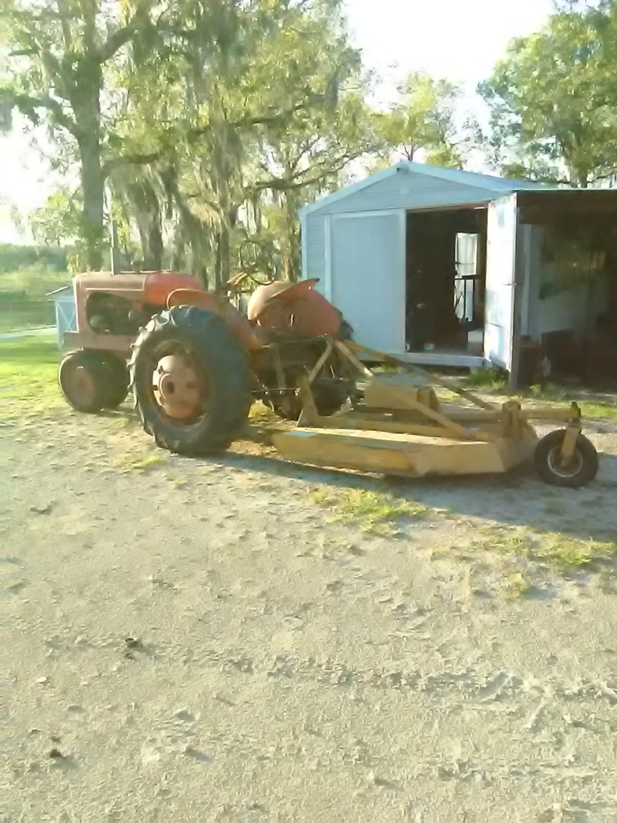

Mowed 5 acres and ran into the neighbors fence.
