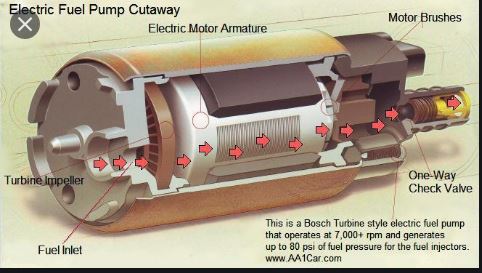

Is it electrical connections ? Motor fail ? Impeller ( not sure how the pumps function Embarrassed) fail or something else ?? Thanks

if your talking about a car/ truck... It is the bushings on the end of the motor.. Bushing wears a little and rotor runs off center. When you stop, the rotor is laying aginst the windings ( no air gap) and will not start back up.... That is why if you SLAM the door or BUMP the truck, it will sometimes take off and run for a while... temporary fix.

The motor that is cooled by the gasoline bearings get loose. The shaft runs a little off and the armature sticks to the field magnets. If you get a car that's been run low on fuel the fuel pumps go out on a regular basis. If your going to change one out get the module instead of just the pump. Changing the pump only is a little Cheeper but you'll be doing it again soon.

Yes, I was asking about a "gas engine/fuel injected engine of NO brand in particular Wink. DD, you speak of a "shaft" (so did Steve), but what does the shaft "drive" ?? is it an impeller like a water pump or a different mechanism ?? Thanks to both of your replies and have a safe and happy New Year Thumbs Up !!

shaft / rotor = same thing... Just a vertical motor with a little pump/ check valve on the end of it.. bushing on each end of the motor... .. lubed and cooled by gasoline as Dave said.... the bushings / brushes ,  wear due to heat and runs off center.
