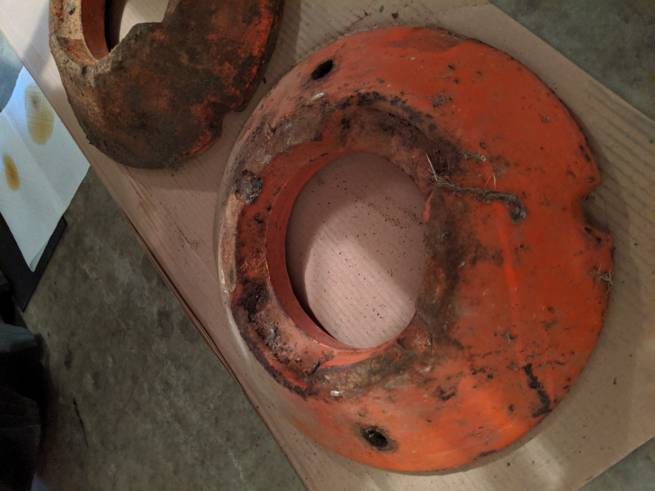

I bought these wheel weights for my 1939 B (at least these are what the guy gave me) but I don't think they are correct? Any input would be appreciated.

looks' c or ca.

From the "Farm Equipment - Knowledge Base" forum, "AC Weights and part numbers" topic by CTuckerNWIL, and info link  http://brianahart.net/weights.htm
Model C Inner Rear Wheel Weights
Also used on Model B with dished center and
D10 with standard center (non-powershift rims)

Late B C D-10

Pancake Rear wheel weights for Early Bs' Very plain except for notch for valve stem. Shown here on Gary's correctly restored 38 B # 751

Those fit inside the wheels on C's and B's with the 5 bolt wheel hub. They don't fit Ca or D 10 they require a flatter wieght
