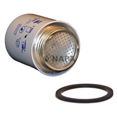

I recently change the oil and filter on my WC and WF and both had good oil pressure before I changed the oil filter. I used a napa 7011 oil filter. Are the napa filters junk? what oil filter is everyone else using? Thanks Zach

Is the NAPA filter pleated paper? The only filters that work on these tractors are filled with cotton fibers. The loss of oil pressure when they went to the plated filters a few years ago cost engines. Many like the Fram filter and Steve (NJ) stocks them in bulk.

Napa scrapped those incorrect pleated bypass filters not long after they came out, they have been correct for quite a few years. The nature of these filters just being stuffed with fibers there's not much difference between any of the brands.

The filter has the cotton fibers in it and looks just like the one in the picture. I put the old filter back on and it has good oil pressure now so its not the oil so it has to be the filter.

The Napa filter is a Wix filter. My B had one on it when I got it, the number was 7011. I got one from CARQUEST for the D10 and the number was 7011. I got another one from O'Reilly's and it said Wix on it but the number was still 7011. I think Wix sells to all of them, they just put a different name on the filter. All my co-workers talk badly about Fram filters, but they're talking about auto filters. To me the Fram c159 and the Wix 7011 look the same if you look at the bottom.

The C159 is the correct number. We've been a Fram dealer for 49 years. Never had a problem with any filter. Car, Truck, Tractor, whatever. Wix makes filter for quite a few companies per the companies specs. Napa, Cat, some Purolator, as well as other brands. Check the center pipe that runs up the oil filter and makes sure its not starting to rot out. I've heard of many cases where the pipe came out with the filter and got thrown away without realizing it was missing. Screw the new oil filter on and no oil pressure at all! We have the new pipes in stock if ya need one. If its solid and looks good, your good ta' go!  We keep the C159's in stock all the time. You should be able to find em' locally though...

That is the correct style filter. You're good to go with this one.
