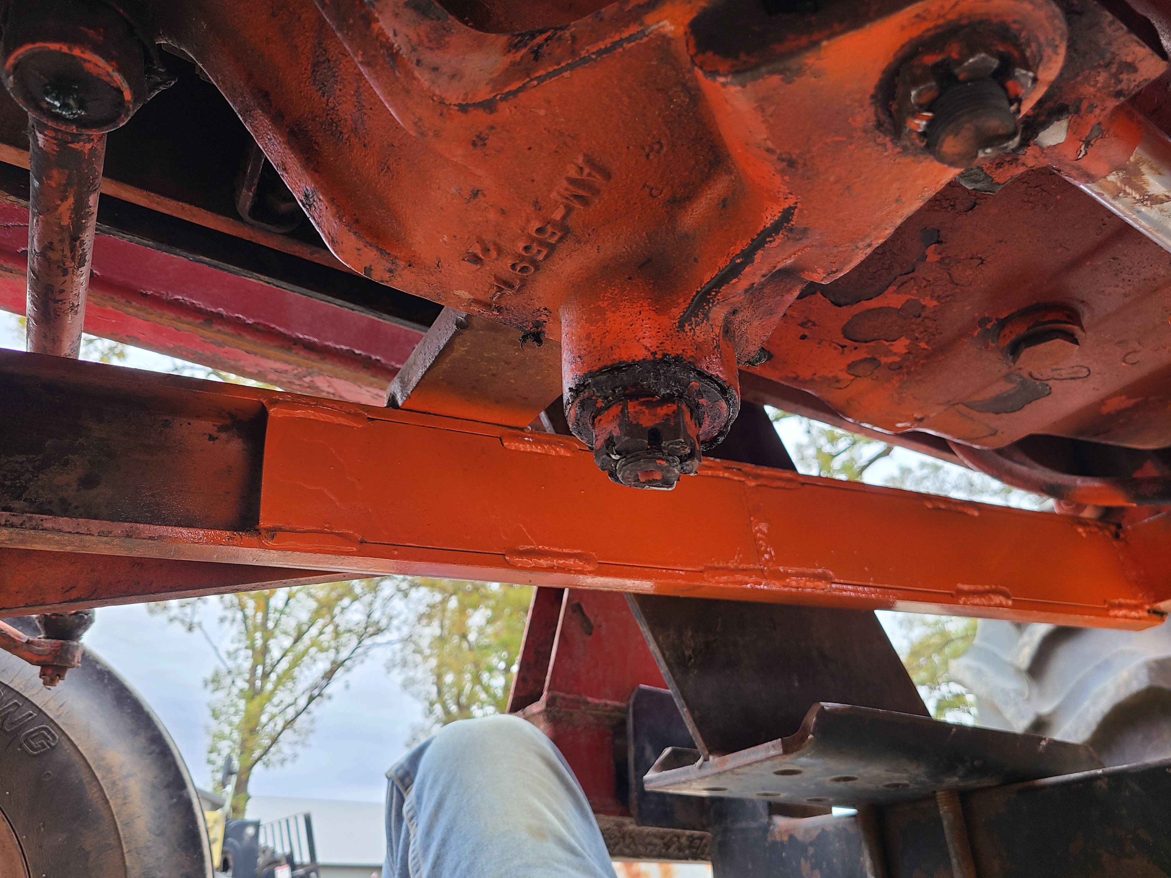

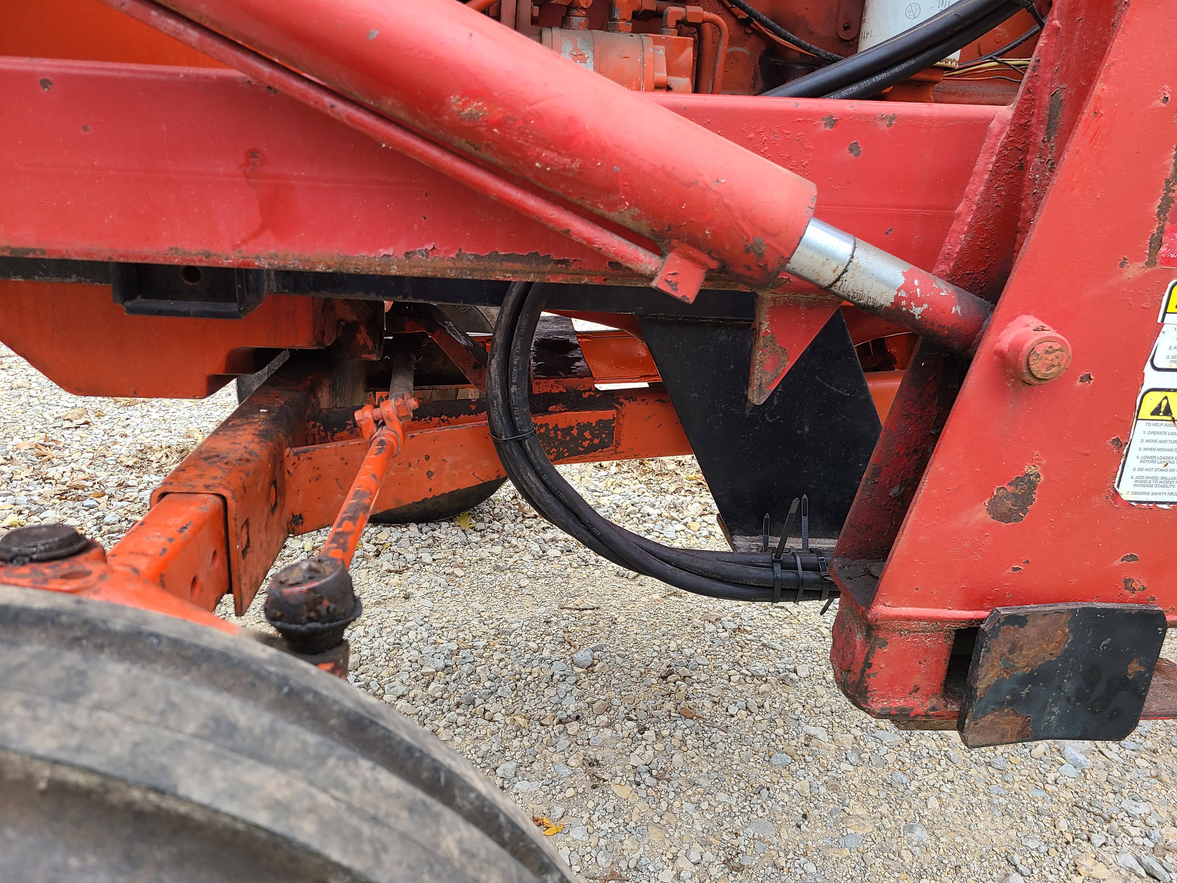

Don't suppose you could get me two dimensions? Then I should be able to fabricoble a plate and use the brackets I have. The vertical from top of bracket to where the square cross bar mounts, and the full from to back of the plate.
Also, what's the square block do on the sides?
Edited by MadCow - 4 hours 21 minutes ago at 12:31pm

Post Options Post Options   Thanks (0) Thanks(0)   Quote dcm Quote  Post ReplyReply Direct Link To This Post Posted: 2 hours 44 minutes ago at 2:08pm
I can take the measurements but it will be a while, my next visit to the farm is planned for April.
I think the square block is just a spacer to keep the mount from sliding left to right. I attached the best photo I could find. The bolt holes which are visible are not used.
I suppose another possibility is some other kind of Westendorf attachment bolts on here, but I can't think of any example.

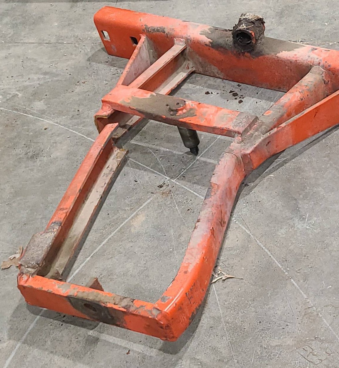

The ends of single steel piece next to corners seem to be the weakest. You can see where mine was welded once in the rear, then broke again in front. We beefed up all along the U-shaped steel where it was alone.

Post Options Post Options   Thanks (0) Thanks(0)   Quote dcm Quote  Post ReplyReply Direct Link To This Post Posted: 2 hours 24 minutes ago at 2:28pm
broken twice in different places
dcm View Drop Down
Joined: 04 Dec 2024
Location: Minnesota
Points: 9
Post Options Post Options   Thanks (0) Thanks(0)   Quote dcm Quote  Post ReplyReply Direct Link To This Post Posted: 2 hours 23 minutes ago at 2:29pm
replaced and beefed up.
