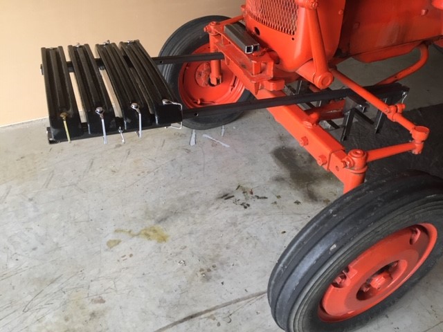

I made this 1" square tubing frame to mount these 35# weights from a cub zero turn mower and can mount 1 to 4 at a time close or extended depending on track conditions to pull 3000# to 3700# classes along with engine side weights under the belly or suitcase weights 40# and 70#.

Thanks For the pics Spears
    Then there is also the question of drawbar length. Most club rules have a minimum of 18" from the centerline of the rear axle to the hook point and no limit on length. From a leverage standpoint with a hook point set at a 20" height and the sled chain at its lowest setting a longer drawbar will lift the front quicker while transferring the whole weight of the tractor to the rear tires at the same time.    Equals Traction
    DSpears. Could you show us a photo of your drawbar setup? From the photos it looks like the front end of your drawbar is attached to the where the pin hitch or snap couple bell is located. I posted a photo of mine here recently. I will measure the length after breakfast. I'm sure its much more than the required minimum of 18". Mine runs uphill to the 20" hook point. A 3" angle iron between final drives support the drawbar and is used to hang weights on too.

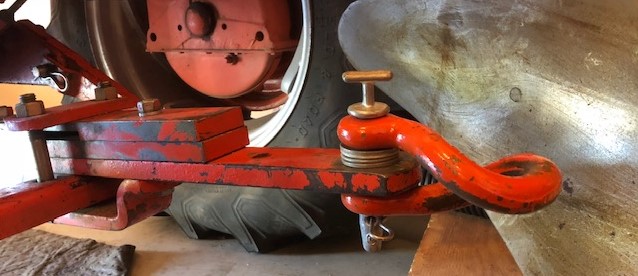

Ken
my draw bar is the standard snap-coupler with 2 stiffeners sandwiched top 1" and bottom 1/2" for adjusting the 18" pulling height with a twisted clevis.
The length of the draw bar will be No less than 35" from the center of the axle or 14" from the end of the PTO shaft if available.

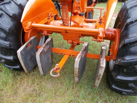

Post Options Post Options   Thanks (0) Thanks(0)   Quote Ken in Texas Quote  Post ReplyReply Direct Link To This Post Posted: 21 Oct 2018 at 9:23am
2500# Bareback CA
Replaced a C flat drawbar that fit with a straight across 3" angle iron using the same mounting system. A place to hang #100 suitcase weights so not to extend out past the rear tires. This pic is using the long pin hitch drawbar. Because of the angle upward the clevis height is 19". With the short drawbar the clevis height is 17"  Height of angle iron is fixed.
    Note the black bungee holding the seat pan down. Lost the seat support spring going down the road. Lucky the spring stayed on the trailer.
Edited by Ken in Texas - 21 Oct 2018 at 9:26am

The ideal scenario for hanging movable tractor weights, is to use the SAME style weight everywhere on the tractor. This allows the driver to make last second location changes without having to go back to the trailer to get a "different" style of weight. I use 7000 series styled weights of the 90 lb and 60 lb thicknesses. So, I can dial in my weight using a 60 or a 90 or two 60's or a 60 and a 90, etc.  My weight can be adjusted every 30 lbs. I also carry two homemade weights that are 10 and 20 lbs and are the same shape as a 7000 weight. Also, with a 1/2" wrench (carried on the tractor) these weights are secured so they cannot ever fall off !!   The same 1/2" wrench also adjusts drawbar height when checking in at the scales.

The clevis does not move about  like you would think.   Do you really think a inch or two or three hook point inches makes that much difference.
    It won't take much fabrication/imagination to move the clevis up to a fixed 20 Inches.

My clevis  is like Ken's and will Not tip!
My drawbar is set at 18" and I can move the two 1" bars underneath the draw-bar for adjusting height in 1/2 inch increments! The top bar has a 1/2 notch milled away in it!

My personal opinion is that 1/4" makes a big difference. Why do you think the majority of guys pulling use a fixed plate or ring, that is set at the maximum height? If height is not an advantage, why is there a rule regulating maximum height? Ask some of the guys that have been pulling for years (PaulB, InjpumpEd, DrAllis, Mack, etc.), how high they run their hitch and if they use a clevis.
Unless the hole in your drawbar is almost exactly the size as your  clevis pin, the clevis is going to tip some with pressure on it. Have someone video your clevis when you're pulling.
Try a fixed plate at 20". In the pulling world, it's a pretty inexpensive thing to try.
