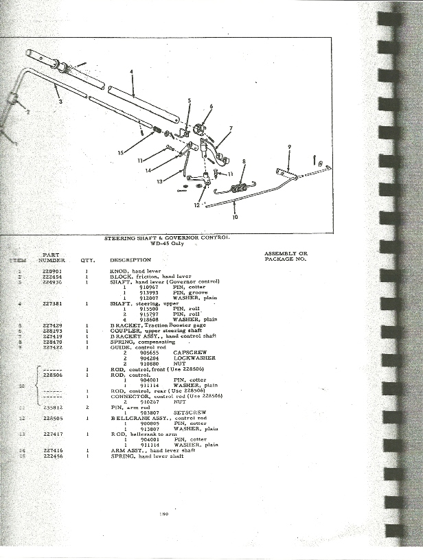

I bought a wd45 gas with factory power steering a little while back the throttle does not stay down when you pull it down my wd was the same when I bought it and I put on the throttle return spring on it was missing. I bought a throttle return spring for a wd45 with power steering but I don't see how it will go on any other ideas why the throttle won't stay down any help appreciated

Will this help?
Don(MO) View Drop Down
Location: Bates City MO.
Points: 6862
Post Options Post Options   Thanks (0) Thanks(0)   Quote Don(MO) Quote  Post ReplyReply Direct Link To This Post Posted: 19 Jan 2014 at 2:46pm
Here you go.

Also the springs on the back side of the quadrant get rusty and lose their strength,that's what happensd on my WD.

  THE POWER STEERING SPRING IS DIFFERENT THAN  FOR STANDARD TRACTOR
   WE HAVE THE CORRECT ONE   1-574-342-4545

 SORRY YOUR PIC SHOWS A CHAR LYNN   NOT AN A-C P.S.
Bruce(IA) View Drop Down
Location: Vail,IA
Points: 84
Post Options Post Options   Thanks (0) Thanks(0)   Quote Bruce(IA) Quote  Post ReplyReply Direct Link To This Post Posted: 19 Jan 2014 at 9:11pm
Those pictures are all AC factory power steering
The char-lyn uses the original spring
Factory PS has all different linkage
Char-lyn just has a bend in long rod

Post Options Post Options   Thanks (0) Thanks(0)   Quote allis 220210 Quote  Post ReplyReply Direct Link To This Post Posted: 20 Jan 2014 at 6:24am
Thanks for the pics! I appreciate the help!

i am in edgerton ohio or the exstreme NW corner of ohio and i have a 1956 wd45 with factory power steering and need the throttle spring you pictured but cant find a part number for it or anyone local that knows what i am talking about the phone number on the forum is disconnected. Please help!!! my e-mail is toolmaker4@gmail.com my phone is 419-658-2712 my name is jeff

Looking in my old parts manual, I believe the part number is 70228470.
I think AGCO still sells them.

Toolmaker,  You might try J C's Farm & Garden Supply, in Bourbon, Indiana (formerly Norm's Toys in Bourbon)
Phone No.:  219-299-4708  I bought one of the correct throttle springs from J C for my WD 45 Factory Power Steering a couple years ago.  Hope this helps.  RickM(MO)
Here is a page from the WD, WD 45 Parts Manual showing the throttle spring for factory power steering.
