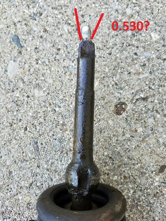

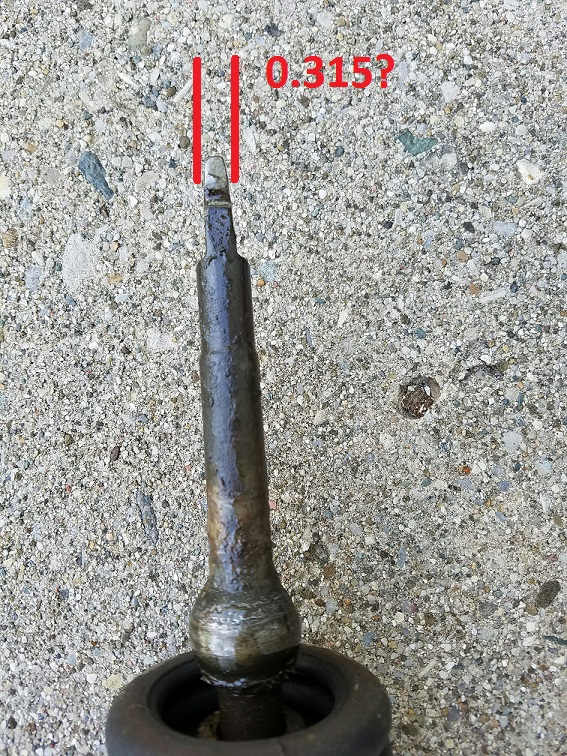

Do I understand the drawing correctly?
The 0.530" "ball" should be when you are looking at the notch in the ball further up? The 0.315 is looking from the side of the notch?

Something doesn't look right, I haven't had one of these off in a year or so. Yours must be really worn. Must be a better picture somewhere. Are you going to weld this up and hand grind to shape?

That one looks used up!!

My impression was the .530" is the widest part of the ball when viewed from the side, and the other one was the thickness when viewed from the back?
That is what the plan is! Weld it up and then grind it down into the shape I am seeing online.
Think it may be too worn down to be saved?

Your added pics have it correct.The rounded part is forward/aft on lever.The .315 is sides.
Never too wore out to try.Won't cost you much more than time/effort.
The grooves are for location pins.They are on the sides.

The flat sided part of the end is "THE SIDE"!!!

When I say front or side, I mean how it sits when installed on the tractor.....

the guy has it right in the pictures .      but that has to be the most wore out one i have ever seen think i would look for another shifter.         that is almost going create a bad spot above the ball,  to weld a complete ball on there.  be alright if a guy can weld a bead and walks away till it cools each time

The slots in the sides of the larger swivel ball may need to be welded in and worked back straight again also. You can get over sized square headed pins if yours are loose too.

Have you taken the shifter out of the housing? The pictures look like its setting in something? Also As mentioned I have welded up the worn slots and also made custom key to tighten up these worn areas too.
I hate to ask but could you take two more pictures with solid background the stones make it hard to see the end. It look like the color is white or lighter color than the rest of the shaft. If it is worn as bad as I think I would be a little worried that what ever was welded on might brake off and be lodged in the tranny??
