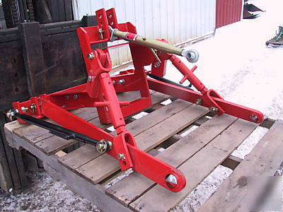

Will a Saginaw three point hitch that is mounted on a WD45 fit on a D17 Series I?

If by Saginaw 3 point hitch you mean the one that looked like the Allis original 3 point adapter I think It would work. Never tried that, but I have an original Allis 3 point conversion that I have used on both my CA and my D14, and it worked fine on both tractors. I have a D17 also, but it came with a homemade 3 point on it. But just by looking at it I think it would work if it works on the WD.
Good luck, and maybe someone else on here who has actually tried it on both tractors will chime in. But it worked great on my 14.

It all depends on how it hooks up. Mine bolts to the hitch hanger brackets, and as I understand the D17 is wider.

I have a saginaw 3pt on my 45 and it will not fit on my series 3 D17. I don’t know if series 1 is the same as series 3.
