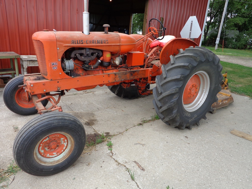

looking for a set of wider front rims for a 45

standard rim should be 16 inch x 4.25 inch wide and 5 bolts on a 5 inch circle ??
Heavy duty rims in 5  bolt pattern would be off a D17... 5.5 inches wide... Not as common and a little more $$.

Have a pair of Buick rims that have 9.5LX15's on them that fit 45's.

IBWD like what year Buick rims do you think they are?

This has been discussed on here different times. I think they are from the late 50's. They have multi-rib implement tires on them, 9.5LX15's if memory serves. I'll try to post a pic of them.

I have 70's era Buick 15in rims on front of my 45. Had to chuck in lathe and trim center hole a little to fit hub.

Brian , have the 16x5.5 on hand

Allis Service Manual and Allis Parts Catalog both state 5.50 X 16"
