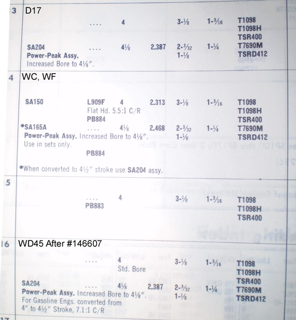

The only way to know what the compression ratio is, on any engine, is to know what the deck height is for the block, the rod length (7.5") and what the compression distance is for the piston as well as the recess volume of the piston/combustion chamber and finally 1/2 the stroke.
My AC Service Manual, does not give that info. Is it available somewhere or do we have that info on this forum?  Such as the cup volume and the standard AC compression ht?
The numbers 2.313, 2.387 & 2.468 are the compression heights of the pistons. The C/H is from the center of the wrist pin, to the top of the piston.
I do have a old TRW catalog (1978) that has this info:
Edited by frnkeore - 15 May 2019 at 5:53pm

My kit makes it 10.1..1 C/R
frnkeore View Drop Down
Joined: 07 May 2019
Location: Southern Oregon
Points: 362
Post Options Post Options   Thanks (0) Thanks(0)   Quote frnkeore Quote  Post ReplyReply Direct Link To This Post Posted: 15 May 2019 at 4:47pm
So your kit would be like the SA165A TRW kit?
