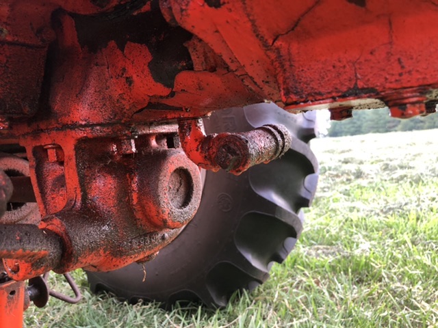

Originally posted by Fred in Pa Fred in Pa wrote:
Hyd. drain is easies place to put it , unless you want to drill a hole in top or side of housing .Where do u want your return hose  laying
I see someone added a nipple on the bottom at some point of life, do you think this would work or should dump in from top?
