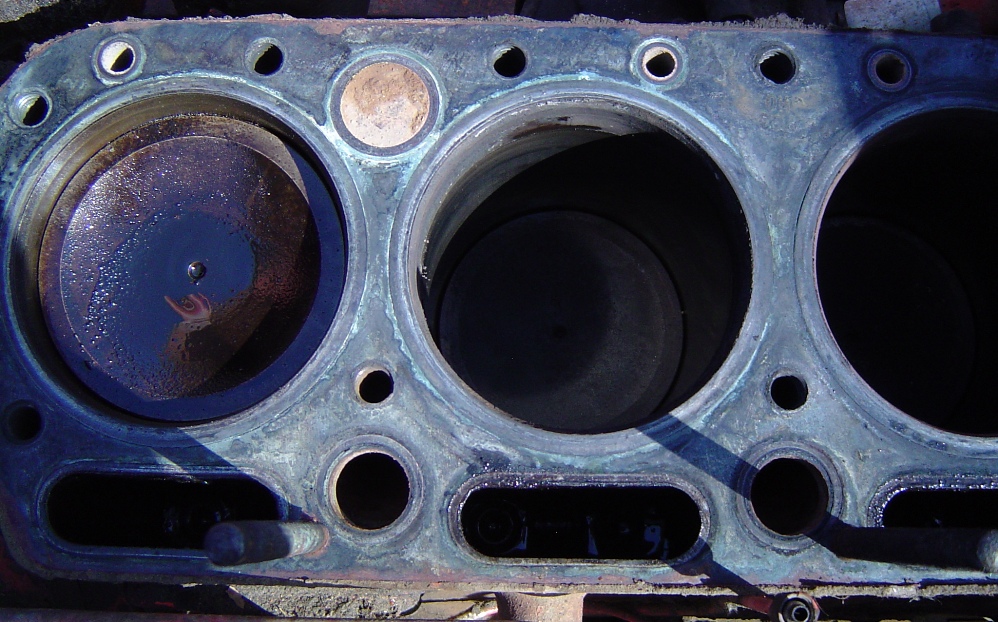

 Found rust on the #1 cylinder wall at the top,

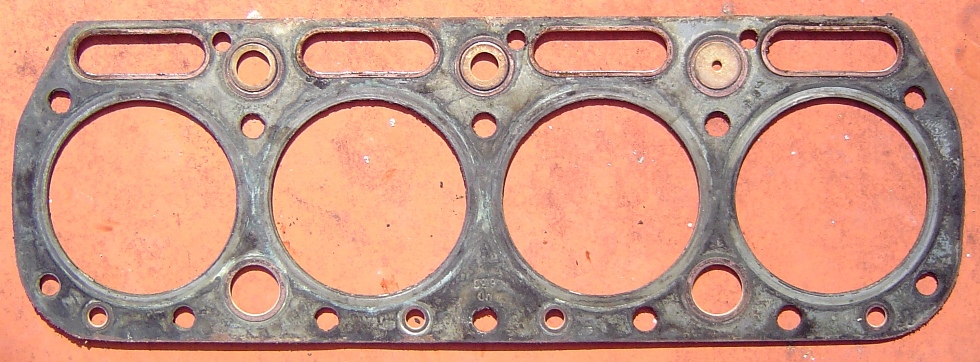

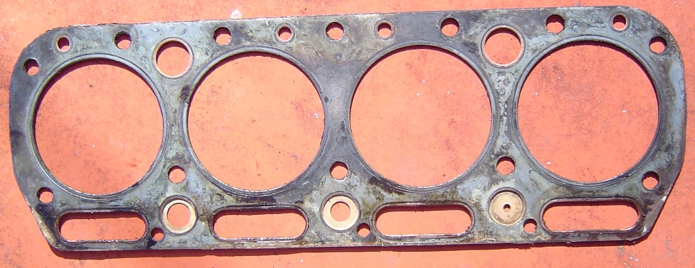

  Found the gasket must not have been sealing very well between 2&3 Cylinders, nor out the side of #2..
 and seen some corrosion from water volute between 3&4 cylinder having white crust between them and then run around 3 and come down into the 2&3 cylinder area. or it looks that way to me.
Top side of gasket.
bottom side of gasket against the block.
 Block, see where the light corrosion is between 3&4. And can see that no. 4 cylinder was the oil burner.

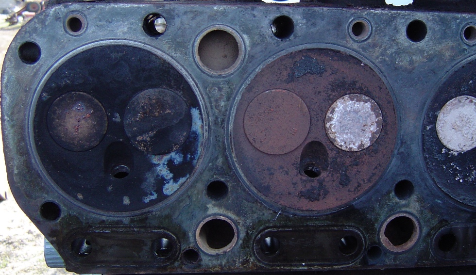

Now the head pics... Cylinders 1&2.  What is the blue corrosion by the intake valve?

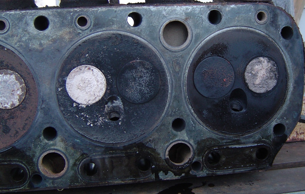

Cylinders 3&4
