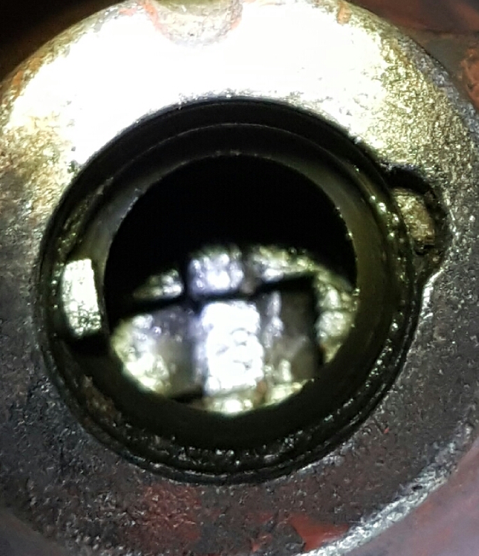

Got the shifter out and the end was worn down. I got everything lined up and put back together. It felt good till i tried to put it in gear and it happened again. So i did the process over again this time i noticed the pieces that make up the square where separated. Im assuming that this is the problem. Is this something that can be fixed or should i source a new tower? Is it something i could have done when i took the tower off? I was wanting some imput before i tore into it. Here are some picture that i got. I hope you can see it ok. Thanks in advance.

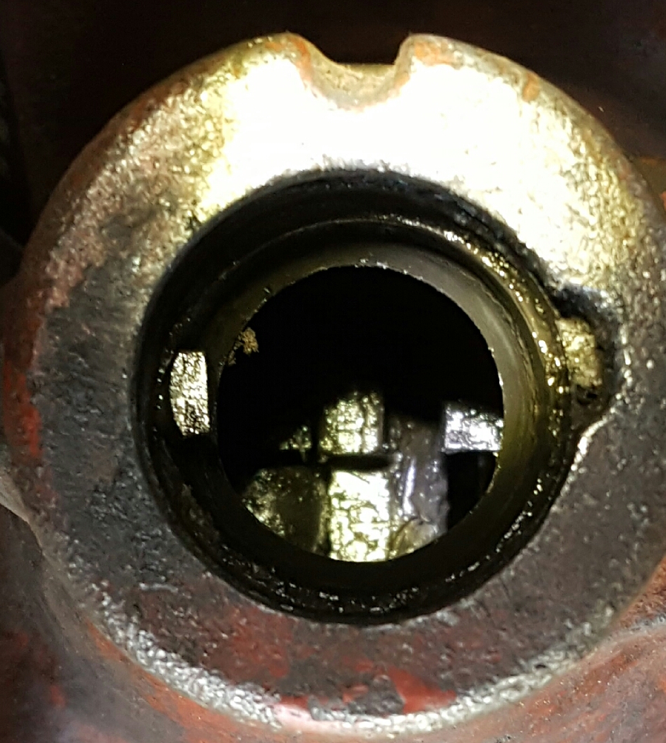

Post Options Post Options   Thanks (0) Thanks(0)   Quote curtis60 Quote  Post ReplyReply Direct Link To This Post Posted: 04 May 2016 at 11:12am
  • null
In the top picture you can see all the forks lined up in neutral. Then in the next two you can see the forks lined up but a gap between them.
Edited by curtis60 - 04 May 2016 at 8:06pm
curtis60 View Drop Down
Joined: 25 Apr 2016
Location: Wisconson
Points: 28
Post Options Post Options   Thanks (0) Thanks(0)   Quote curtis60 Quote  Post ReplyReply Direct Link To This Post Posted: 04 May 2016 at 11:13am
That gap is big enough for the end of the shifter to fit through.

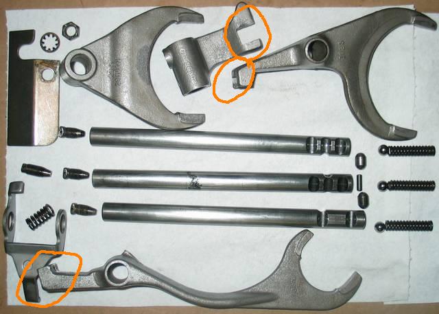

Post Options Post Options   Thanks (0) Thanks(0)   Quote CTuckerNWIL Quote  Post ReplyReply Direct Link To This Post Posted: 04 May 2016 at 4:41pm
When all 3 forks are lined up to neutral, there should be no way the ball can get out of the slot. I circled the top of the forks where the "slot" is formed when they are all lined up.

Post Options Post Options   Thanks (0) Thanks(0)   Quote curtis60 Quote  Post ReplyReply Direct Link To This Post Posted: 04 May 2016 at 8:04pm
So what is wrong with it if the forks can slide right and left and a gap can be formed when it is in neutral between the forks?

Post Options Post Options   Thanks (0) Thanks(0)   Quote Sugarmaker Quote  Post ReplyReply Direct Link To This Post Posted: 04 May 2016 at 8:21pm
Doesn't look like you got the tower off yet. And if you didn't then something needs attention in there. I cant tell from the pictures if its in neutral or not? But at some point you should be able to pull the tower and evaluate the amount of wear or it something is broken. I would move the forks around till you can get the tower to come off. It should come up and off with not much force if any. Hope that helps a little??

Post Options Post Options   Thanks (0) Thanks(0)   Quote CTuckerNWIL Quote  Post ReplyReply Direct Link To This Post Posted: 05 May 2016 at 7:46am
I can't tell from the pics, but it looks to me like there is an ear missing on one fork, or it's not in neutral?????? When in neutral, the ball should be contained in a rectangle formed by the 3 slots in the forks.
