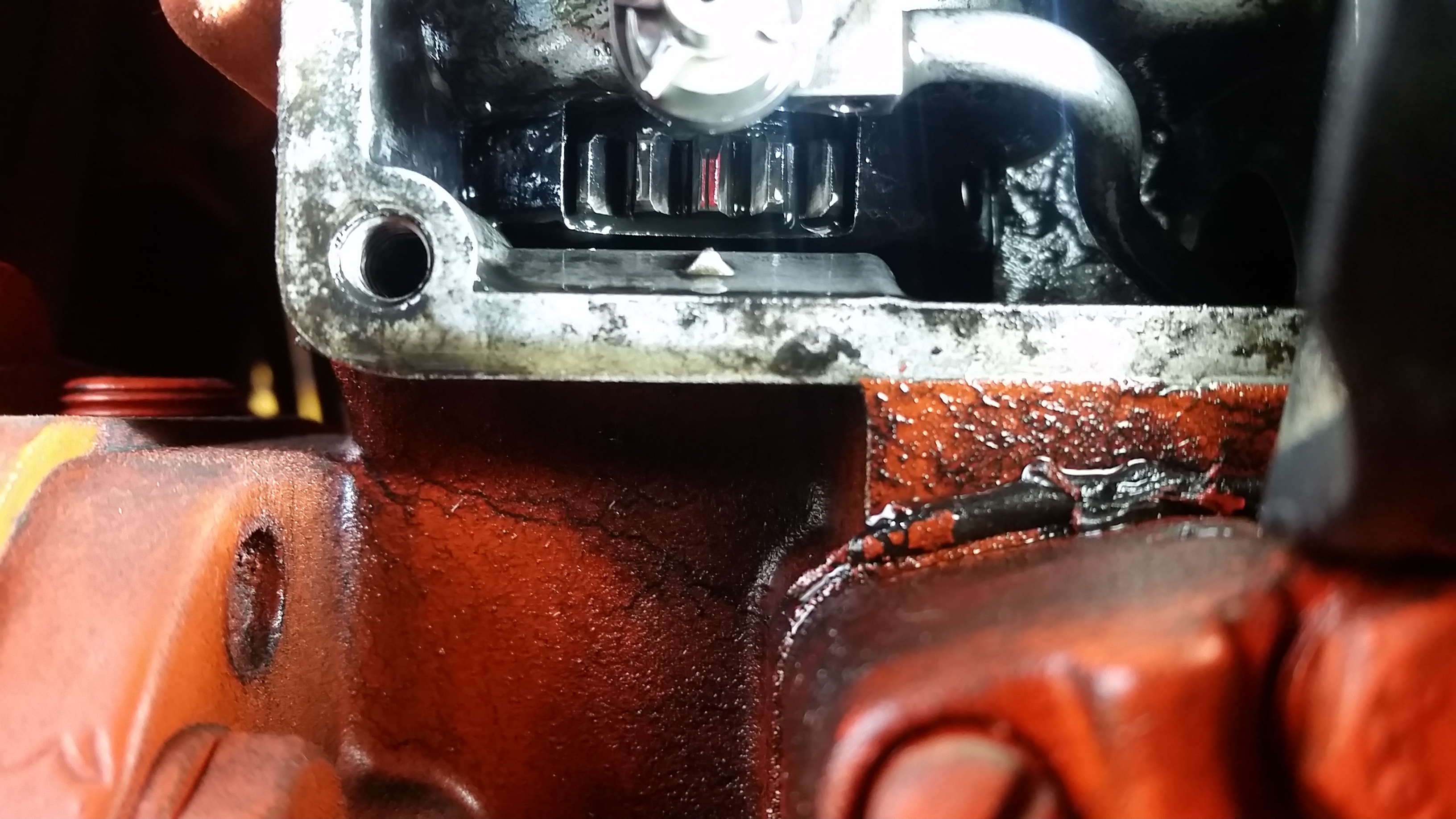

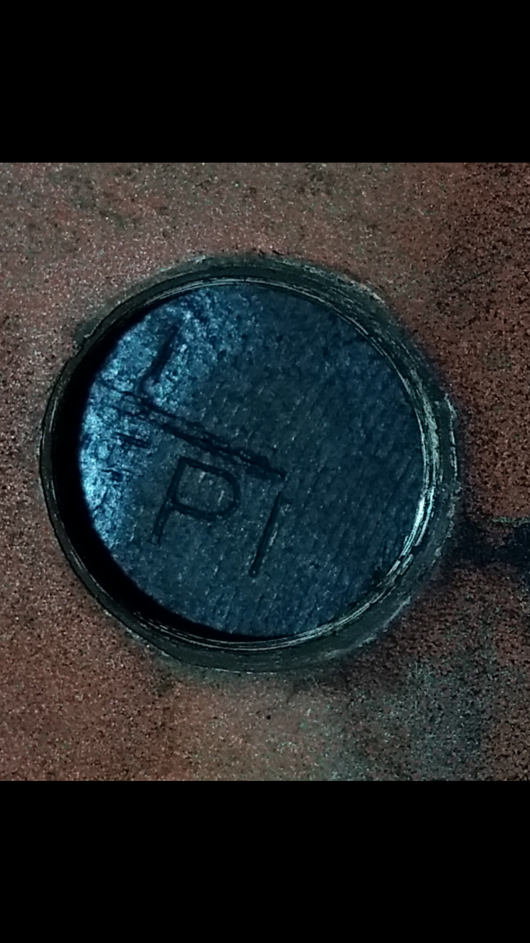

Post Options Post Options   Thanks (0) Thanks(0)   Quote MattLF9 Quote  Post ReplyReply Direct Link To This Post Posted: 14 Aug 2020 at 4:11pm
Is this correct?
Still can't get it to fire, it's definitely getting fuel.
Edited by MattLF9 - 14 Aug 2020 at 4:18pm

injpumpEd View Drop Down
Location: Walnut IL
Points: 5097
Post Options Post Options   Thanks (0) Thanks(0)   Quote injpumpEd Quote  Post ReplyReply Direct Link To This Post Posted: 14 Aug 2020 at 5:33pm
the mark in the pump is only for assembling it, not installing it on the engine. That mark is a pointer on the pump drive hub, seems there's a pipe plug to take out to see it. These can really be a pain to get people to understand.

Post Options Post Options   Thanks (0) Thanks(0)   Quote Michael Crowe Quote  Post ReplyReply Direct Link To This Post Posted: 14 Aug 2020 at 6:05pm
Matt, you’re not even close. Whoever timed it did not have the directions. Michael

MattLF9 View Drop Down
Joined: 27 Nov 2009
Location: Minnesota
Points: 187
Post Options Post Options   Thanks (0) Thanks(0)   Quote MattLF9 Quote  Post ReplyReply Direct Link To This Post Posted: 14 Aug 2020 at 9:33pm
Got it running, timing was way late.
