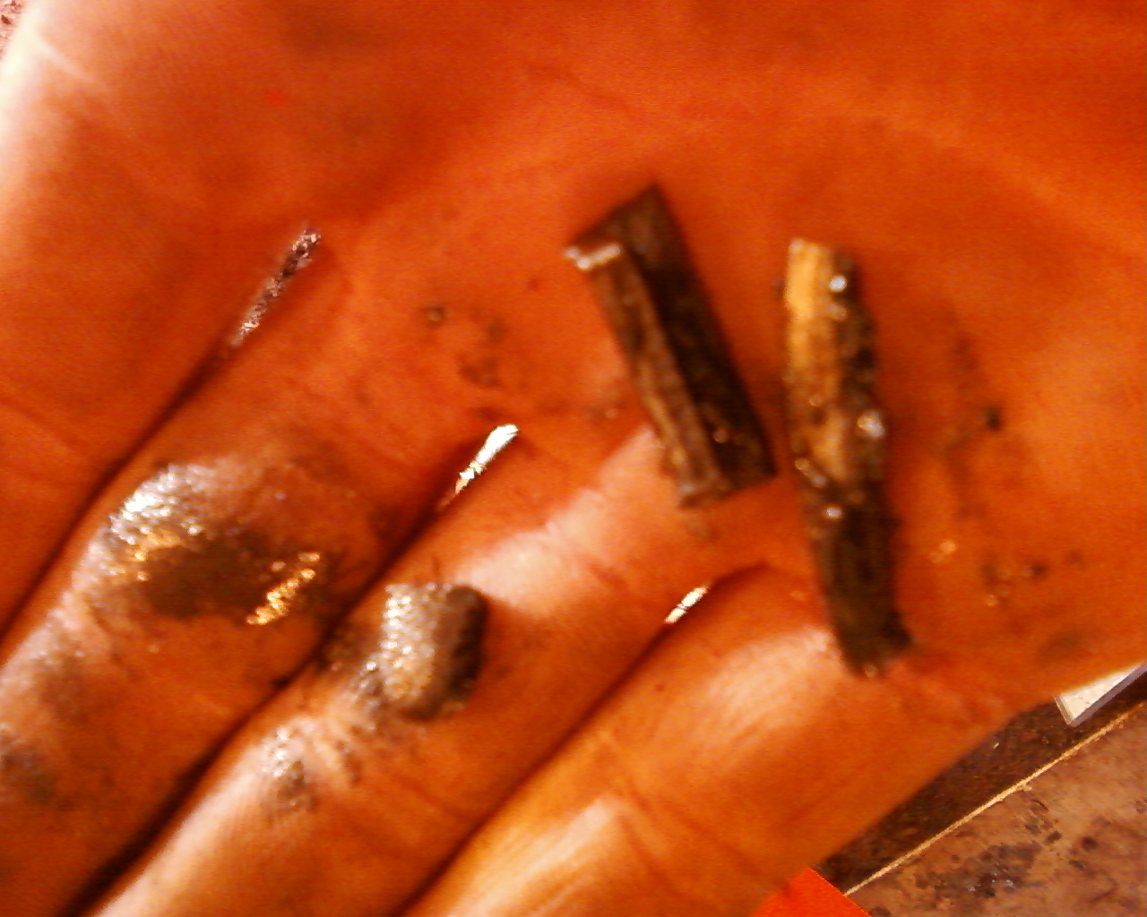

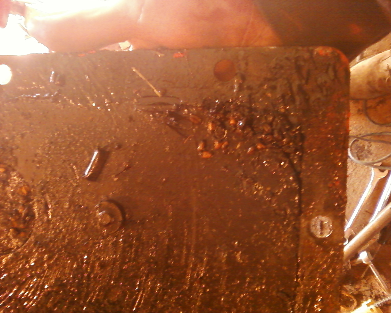

Took the bottem cover off the clutch/flywheel housing...found a few pieces of metal. Never had any trouble with it, so I have no Idea how long they've been there. Anything I should wory about? Maybe from the starter? I remember something may have broke on the starter and maybe that was why it was rebuilt? Also noticed a grease zerk in there? does this need to be regularly greased? Thanks

I think it would be from the ring gear and starter.

Thats what I was thinking.

Also, Is there supposed to be a gasket for that cover (the entire thing) I noticed a little oil drip on the bolts (reason I took it off in the first place)

No gasket, there's nothing to hold in there,it's just a cover to keep crud from getting on your clutch and throwout bearing,

from what you are showing in the picture,that is a tooth off of the starter bendix,from a previous injury...

That would make sense. I knew something broke in the starter so grandpa had the whole thing rebuilt, this was 3 or 4 years ago, so I couldn't remember what broke. Guess it must have been the bendix.
