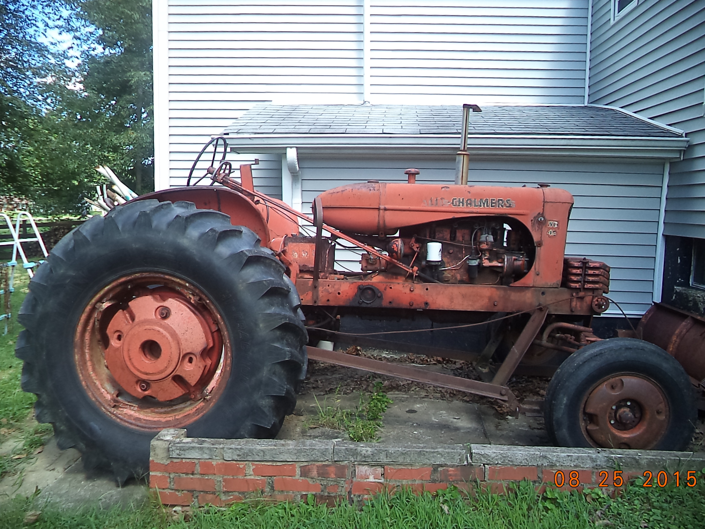

Fixing up the old wd has oversized tires was wondering what the size on the rear is supposed to be. Thanks.

Thanks everyone for the response. I think im going to go with the 13.6 28.
