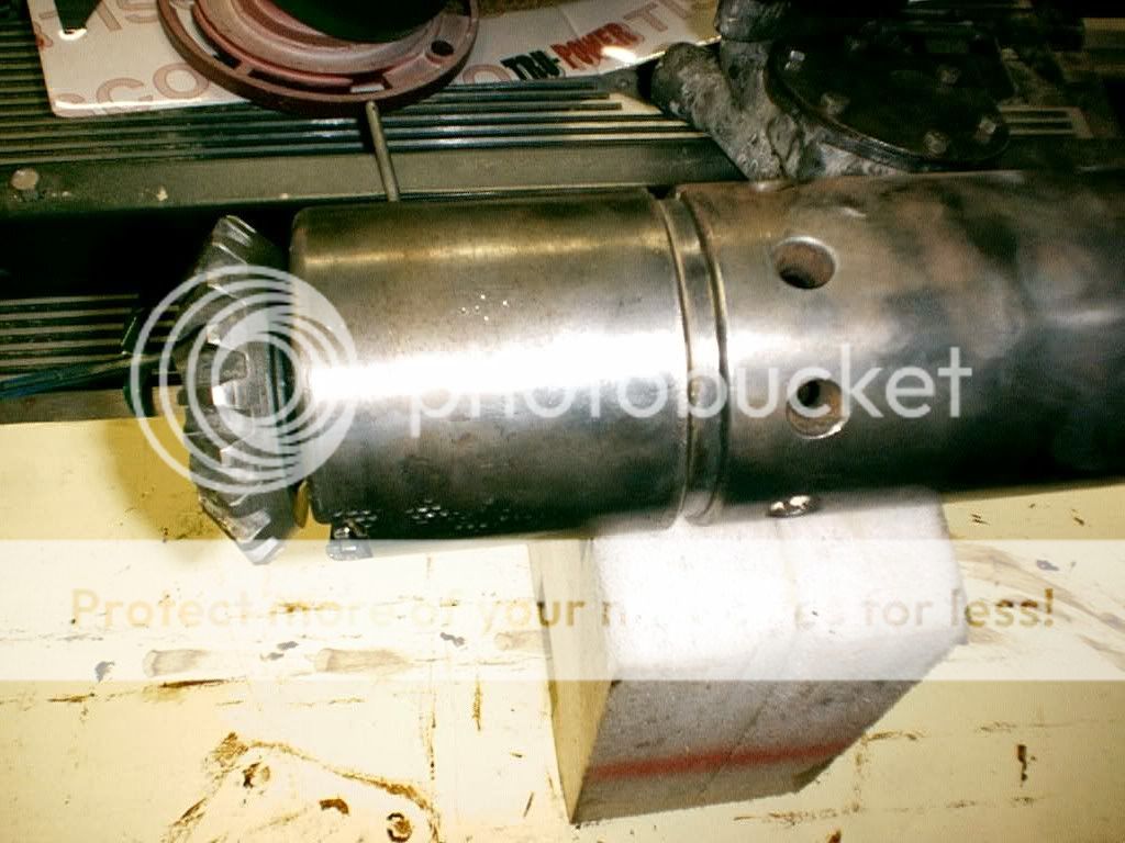

The mark may not be an arrow, may be only a small punch mark on the main channel above the pulley, as it is on mine, it may be hard to find, clean the top of channel well to see.  May only be a small mark on the pulley shaft as well, although on mine it is a chisel cut about an inch long, so easy to see!

And I'll add in here to allow 1/8" rotating backlash when you find the hole that allows that much play.
This slack is to allow for the metal to expand as the gears heat up while running and therefore tightening up into the matching gear without putting anything into a bind.
My dad informed me of this when we'd belt up to the hammer mill to grind feed.
You can look into the screw hole and see one of the holes on the pulley shaft as it slides in and know which hole to square up to give you that play.
The set screw will fit in the hole to lock it in place and the big lock nut will keep it from backing out once cranked down. HTH.

I just looked at mine to see the markings. It has 3 punch marks on the big shaft. 5 on the side of the frame aligned with the ones on the shaft and 2 more on the top side of frame that are easily visible. So its well marked.. All in line.
