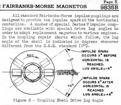

To set the governor gear correct the slot for mounting the mag needs to be horizontal when any of the pistons are at TDC.  Since this turns at crankshaft speed you'll see by turning the engine with the hand crank that no matter which pistons 1&4 or 2&3 are at TDC the slot will always be horizontal when one set is up.  The mags for these all impulse fire on the horizontal, then once up to speed the impulse coupler doesn't come into play and the spark is advanced to the proper fire mark.  Make sure that you have the crankshaft on TDC though, look either at the mark on the flywheel or look at the set-screw on the front crankshaft pulley it will be pointing straight down when 1&4 are at TDC (WC not sure what the pulley looks like on a WD).  Since the pistons dwell at the top for quite a few degrees just looking at the pistons isn't good enough.
