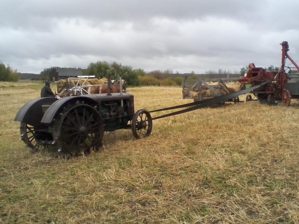

Post Options Post Options   Thanks (0) Thanks(0)   Quote Alberta Phil Quote  Post ReplyReply Direct Link To This Post Posted: 19 Sep 2017 at 10:55am
Here's a belt pulley in use.  Spent all last Sunday running the threshing machine with the '28 Allis.
