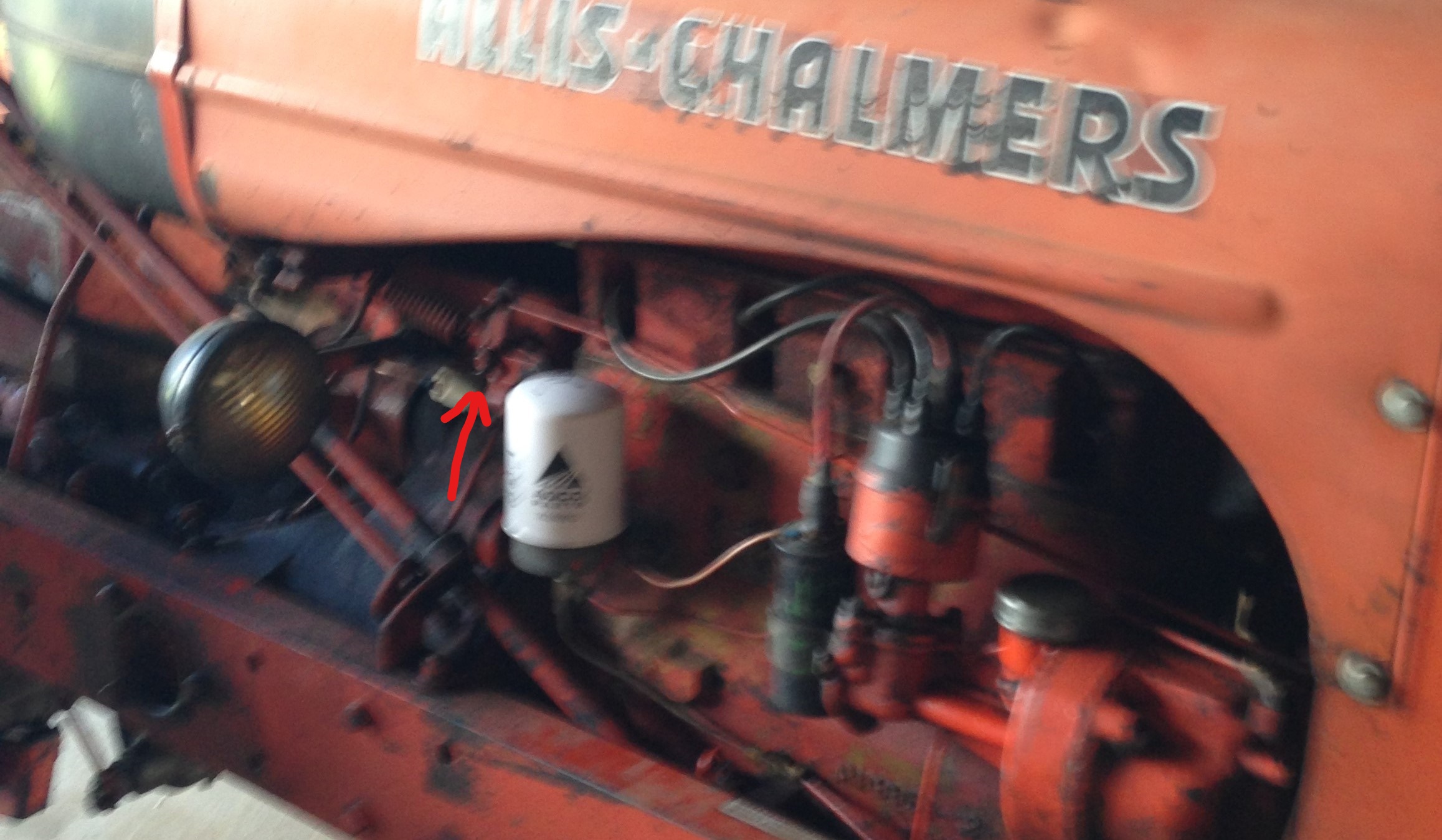

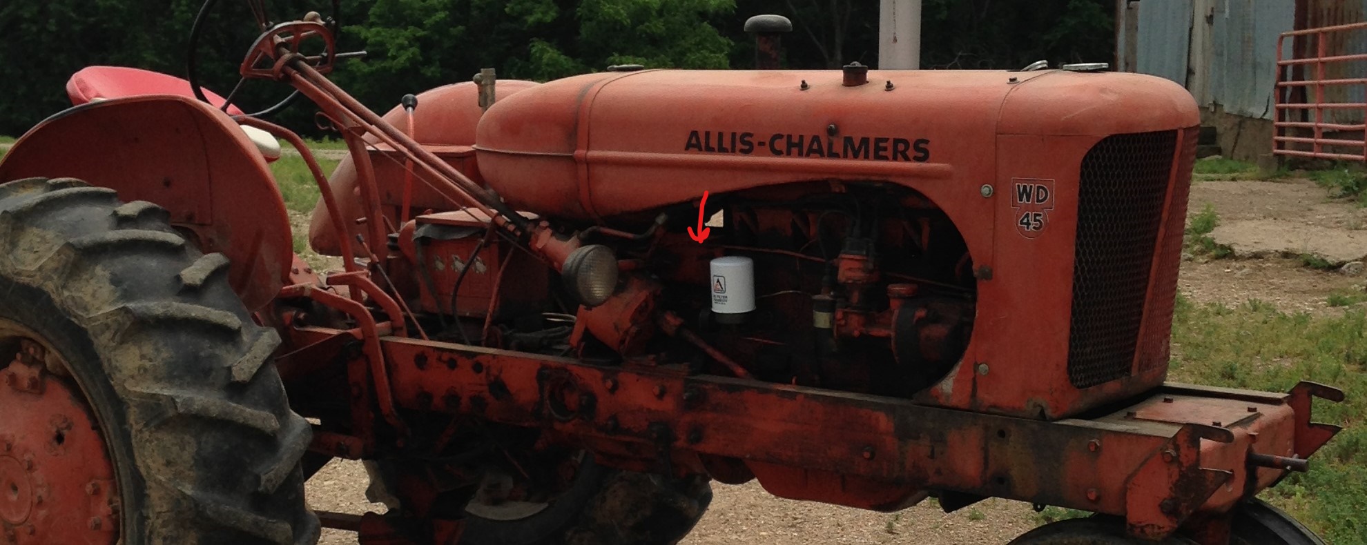

Post Options Post Options   Thanks (0) Thanks(0)   Quote ac160 Quote  Post ReplyReply Direct Link To This Post Posted: 22 Sep 2022 at 8:14am
I agree with the Dr.The power steering and non power steering linkages are different. and one w/o power steering probably had power steering at some time.  If the pictures aren't too bad  The first on is non powersteering and the arrow points to the linkage.  The second is powersteering and the arrow points to the same spot to show no linkage.
