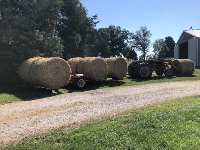

This tractor has been going strong since ‘57, on its 3rd overhaul, 2nd loader, 4th set of rubber, 3rd front end. In early years, Was the only tractor for a 700 acre farm, plowed, planted, picked corn, pulled combine to late seventies, has been moving round bales since ‘81. Never shedded.

What kind of loader you got on there, a 445? Looks nice.

This is a New Idea loader, I believe 504B? The frame is a little longer giving more reach and you can access the filter a little easier because of the tower location.

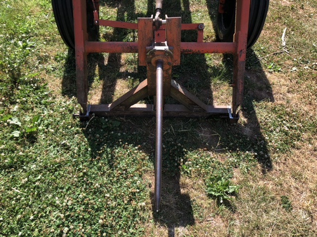

Do you have a bale spear in the bucket or just how are you lifting the bales? My father-in-law recently gave me a WD for doing some horse stuff and one of the things I want to be able to use it for is lifting and moving round bales. It came with a bucket (not sure of the brand but it's old and the framing for it is round) but it looks like your tractor has the setup I'd be after!

I will get you some pictures maybe tomorrow when I’m at that farm. It is a machined car axle (I believe 8 3/4” Mopar)bolted to a 3pt frame. My father made these up several years ago. Most of the ones I see, the shaft is too large and will not go in tight bales. We have another shorter one for silage bales, they are much more dense. The one on there now is about 2ft long and maybe a little more to support 4ft wide bales. I think you can just use the loader you have. We had a 445 AC loader on there at one time, just needed a little more reach to double stack bales. This loader has some slight advantages for him because you can see very nicely over the tractor. The top loader may be built a little stronger as we have never cracked it.The brackets are designed lighter for the under carriage on the NI and have wore these out several times over 40 years of hard use.
