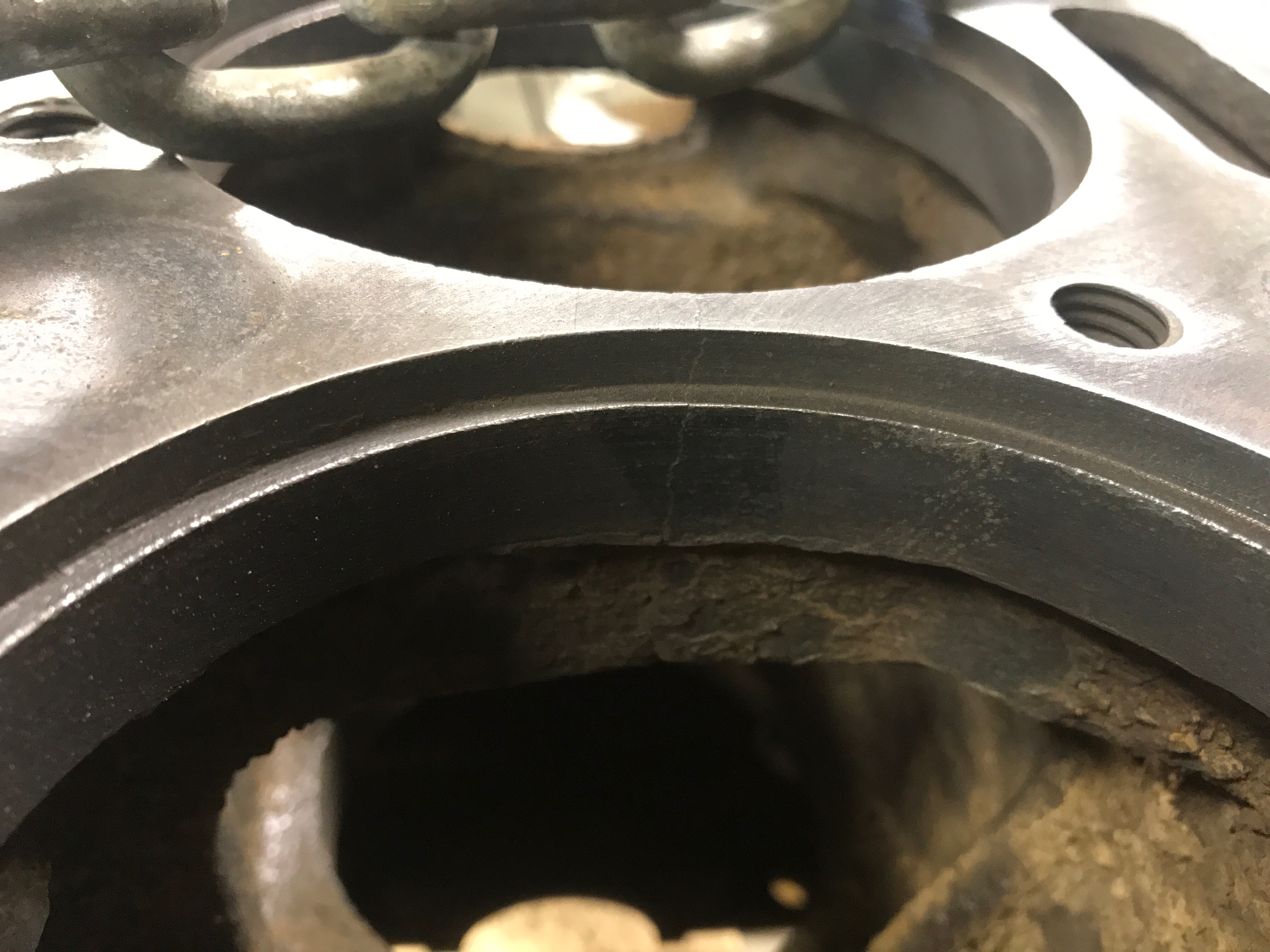

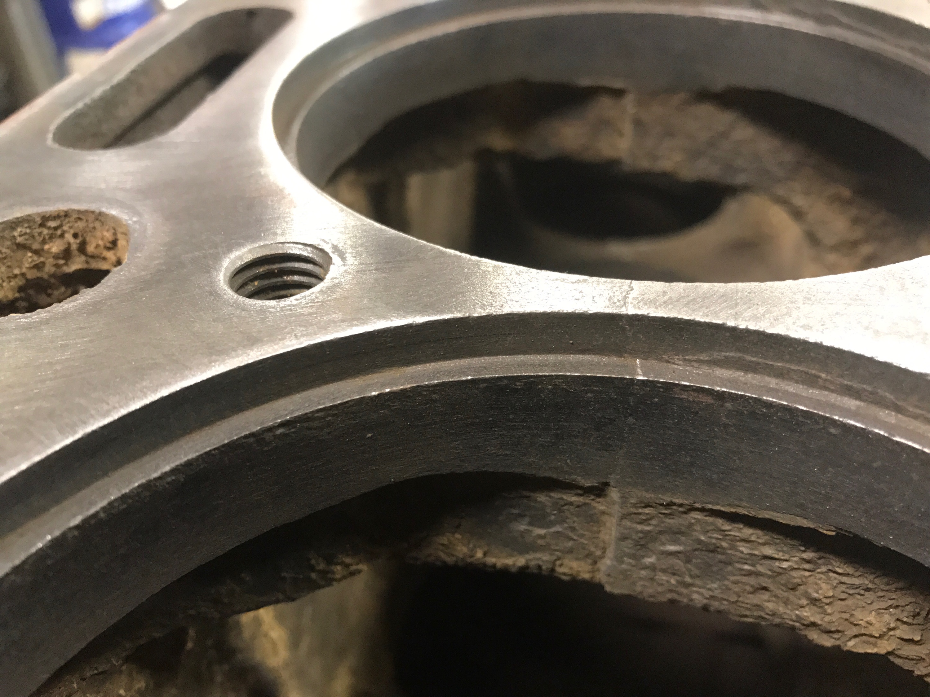

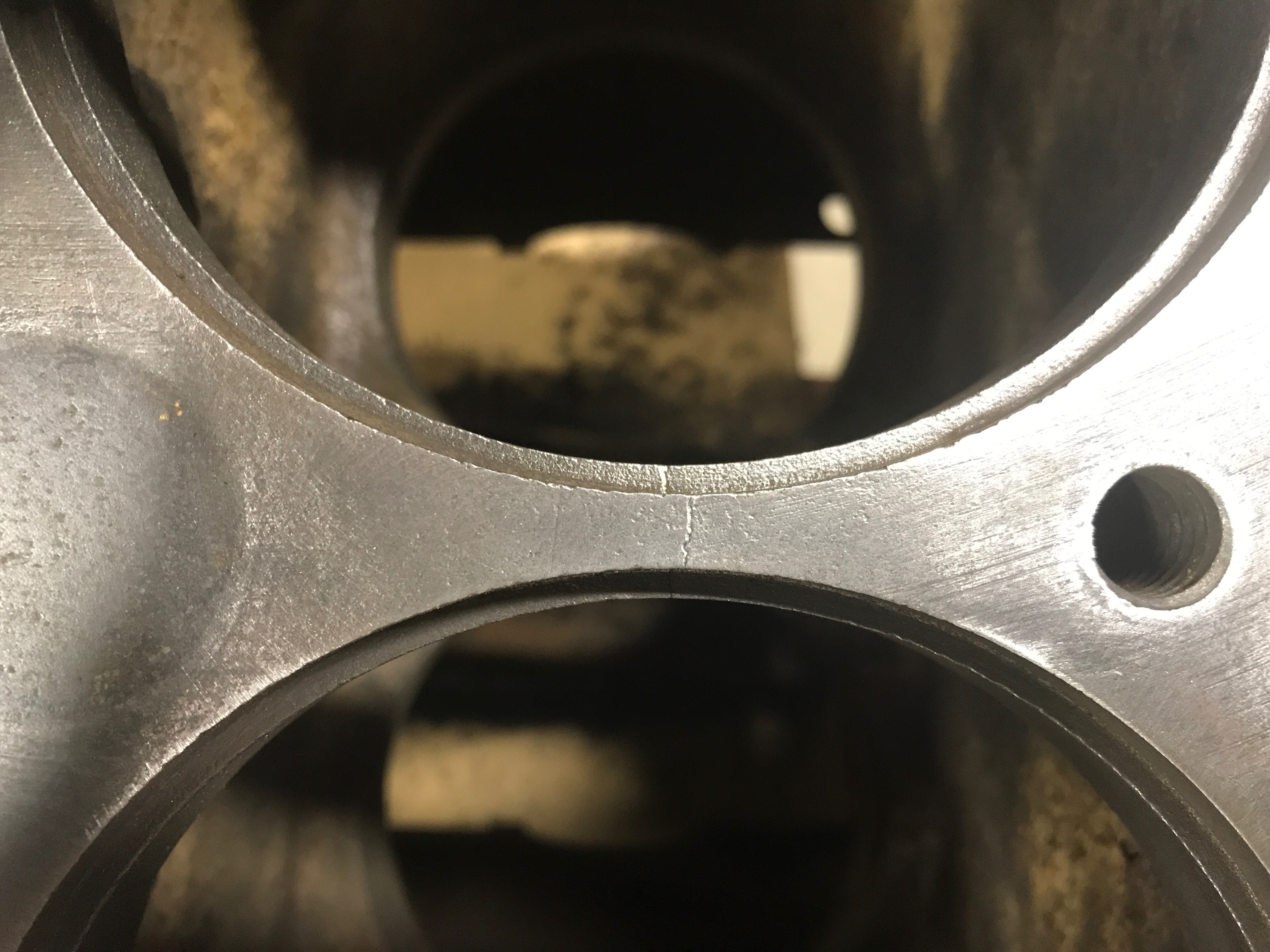

Here are the pictures. From front to back between cylinder 1 and 2 is the worst cause it is cracked all the way around. The other two are hairlines that have started.

It won’t let me post the other pictures of the other cylinders. But they are very small and not near as bad as the one that I showed the pictures of. Both of them each are about a 1/4 in crack

The nice thing about those cracks is this.......they haven't spread apart and the deck surface appears to still be flat.

do not...I repeat...do NOT "doctor" those cracks in any way, you just run the risk of making them worse and turning a usable block into junk. Those cracks are about as tight and smooth as can be, put it back together normally and forget it
