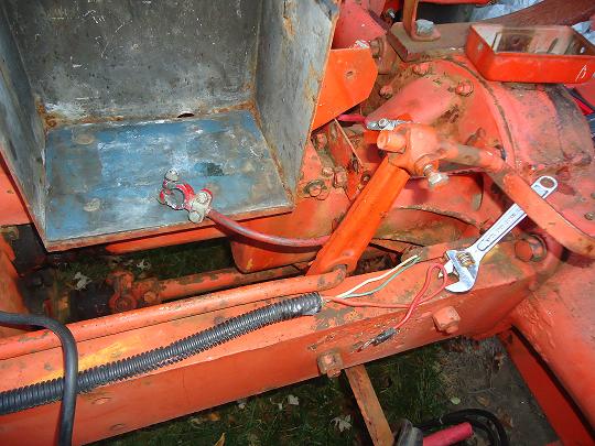

My grandpa passed away and left me his 1945 wc. He was rewiring the tractor then got sick and it didn't get finished. I would like to get it running again but I don't know much about wiring. I know it was converted to a 12 volt. Any help or suggestion would be very much appreciated.
    Thanks, Trent

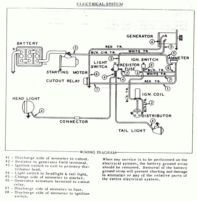

Post Options Post Options   Thanks (0) Thanks(0)   Quote CTuckerNWIL Quote  Post ReplyReply Direct Link To This Post Posted: 23 Oct 2011 at 9:36am
for 6 volt distributor set up.
