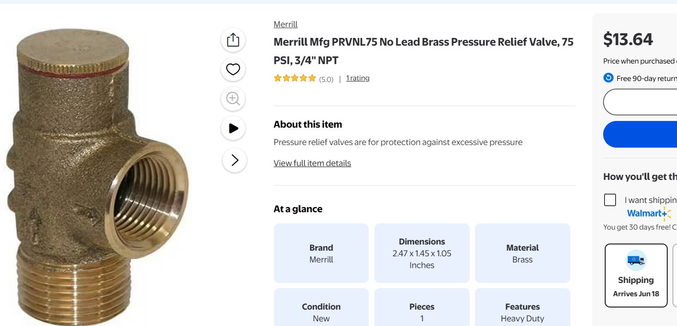

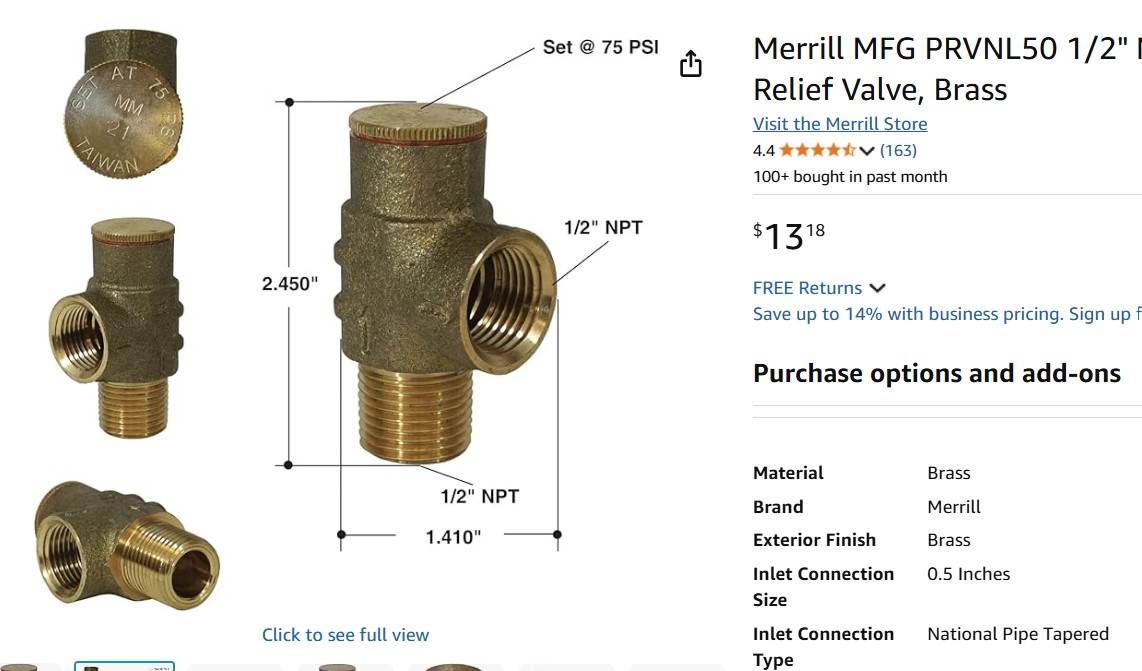

sounds like a plan.. TEE into the discharge...a RELIEF VALVE that opens and dumps back to the creek or suction side... you dont want to REGULATE the pressure, you want to DUMP the water when pressure reaches 50 psi...
something like this at WAL MART... dont know what your pump PSI is capable of ??

a variation at AMAZON...
