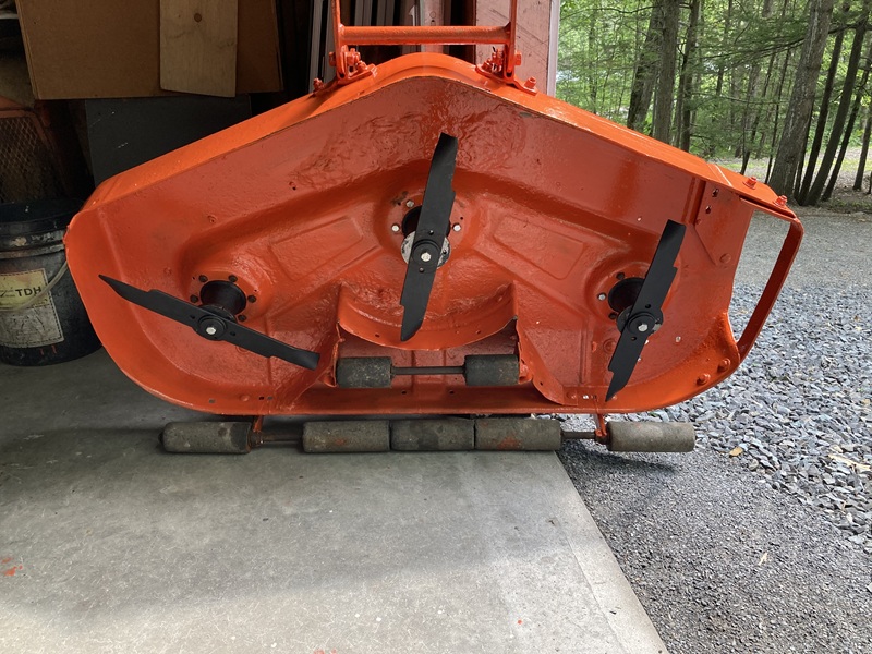

I purchased a 1979 716H with a 48 inch deck, a couple of years ago, original blades but very dull.  The deck bearings were bad, too much play causing vibrations.  I replaced all six bearings spindle bearings - lots of choices online, I sourced from local Simplicity dealer
No more vibrations and the sharpened blades work fine
Replacing the deck spindle bearings take some time - lots of good YouTube examples
Just passing on my experience
The Allis Chalmers/Simplicity tractors and mowers were built like a brick XXXXhouse!!! However, some maintenance required
Good luck with your project
Here is my deck
