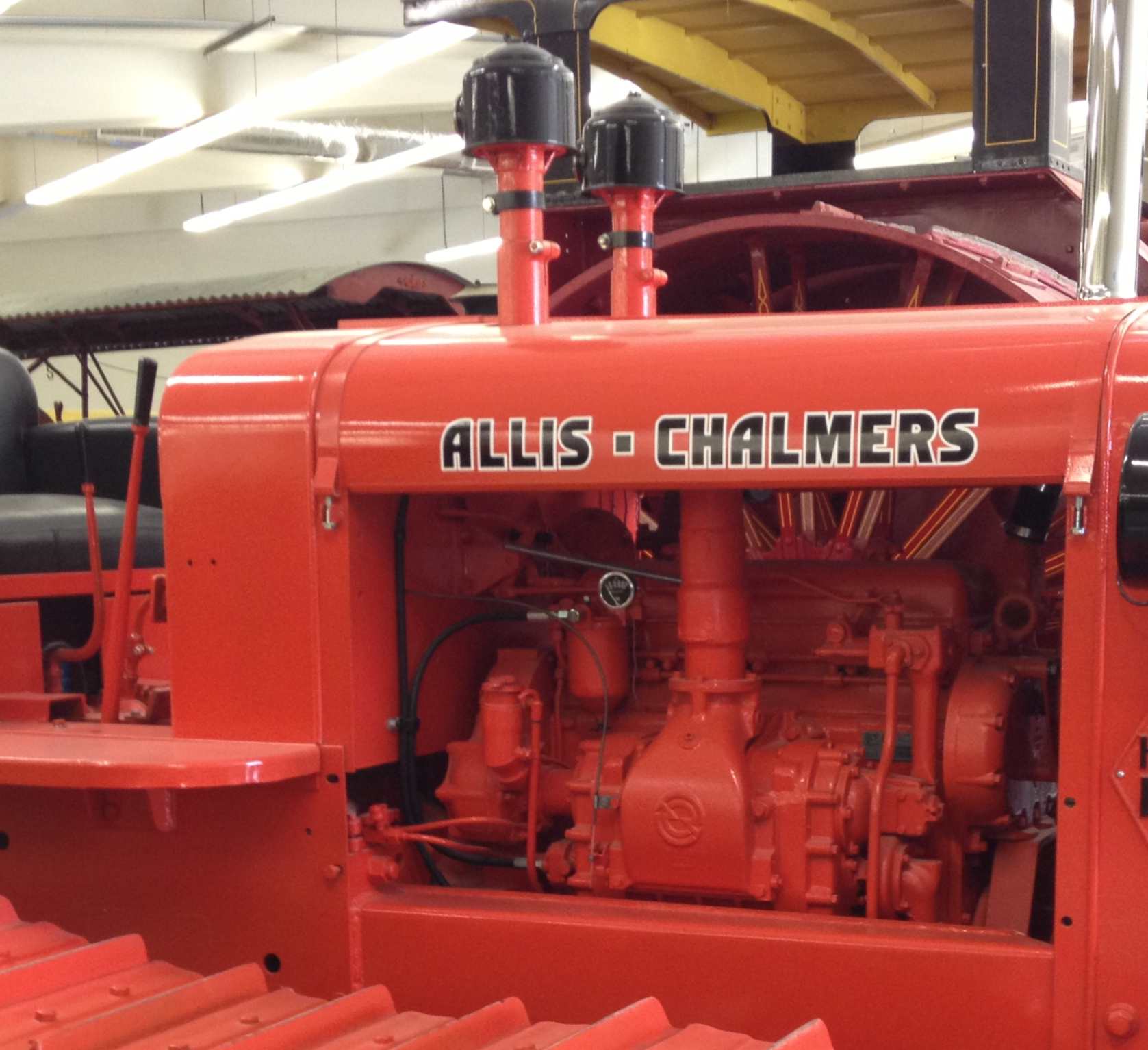

Is hhis HD10 a two stroke diesel? What are the pro's and con's vs. 4 stroke.

Yes the HD10 is supposed to be a 2 stroke.

Thats a destroyeit in that 10. Love the sound of them... hate the oil leaks all over...
 Some start so easy and others are harder than heck to roll smoke.
 Somebody took time to make the HD10 look good.
BrianC View Drop Down
Joined: 16 Jun 2011
Location: New York
Points: 1619
Post Options Post Options   Thanks (0) Thanks(0)   Quote BrianC Quote  Post ReplyReply Direct Link To This Post Posted: 24 Feb 2013 at 9:18pm
There is a blower inside that housing with the big pipe?
The crankshaft center line is just below top of frame rail?
The cylinder liners are dry wet cast in?  Intake ports are
below cooling jacket?
I never got my hands on one, hence all the questions.

That should be a 4-71 Detroit, I have had several of those (still have one). They are dependable as the hills usually and yes likely to develop oil leaks with time. They are very loud, you need hearing protection for sure. They should be run at fairly high throttle to prevent a pattern of slobbering oil from the air box drip tubes (no idling for coffee break). I have found mine to be easy on fuel for the work they perform. Service and rebuild costs are very reasonable, parts are plentiful and cheap. The big advantage is that of running without a fuel injection pump, simply a primary pump worth around $100.00. You can put in varying size injectors depending on the power you need. Some may need a sniff of ether for easy start, good cold weather starts with some ether. Any time I see a machine for sale with any 2-cycle Detroit engine I feel like I'm in good hands. You have to however determine what shape the engine is in which is relatively simple. Funny thing is when you ask opinion on these 2-cycle diesels people generally love them or hate them.
