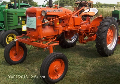

This 1952 High Crop CA showed up at one of our events!
It was just for show so I do not know how it performs.
