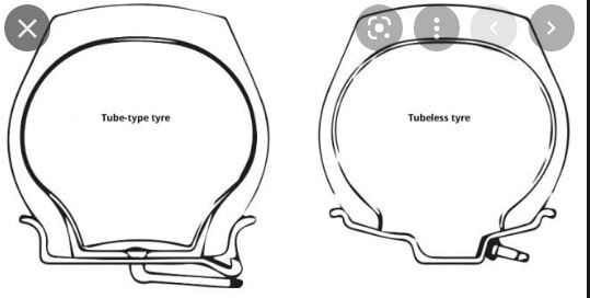

yes jay... on the old TUBE TIRES, the rim bead is basically 90 degree to the rim ring... on a TUBELESS TIRE the bead sets much less than 90 degrees.
Points: 25247
Post Options Post Options   Thanks (0) Thanks(0)   Quote jaybmiller Quote  Post ReplyReply Direct Link To This Post Posted: 08 Mar 2022 at 7:01pm
GREAT , I learned something today !!
I also got ONE bolt off my new ride without needing any bandaids too !!!
Points: 90808
Post Options Post Options   Thanks (0) Thanks(0)   Quote steve(ill) Quote  Post ReplyReply Direct Link To This Post Posted: 08 Mar 2022 at 7:38pm
this shows the TUBE TYPE as a split rim.... but the LIP design is the same ...
I am doing a pair of front rims for a backhoe right now and the center hub is RIVETED to the rim in the center..... And the LIP is about 90 degree .... so BOTH of those would clue you in to use a tube.

Upon further inspection, I believe this to be a much newer rim than the other side.
Tire shop swears it’s nice inside and is a tubeless wheel.
The other side has a tube and an older looking wheel.
I’ve found what appear to be what this one is on Yesterday tractors. Says tubeless and the pic looks just like the tubeless above in Steve’s post.
