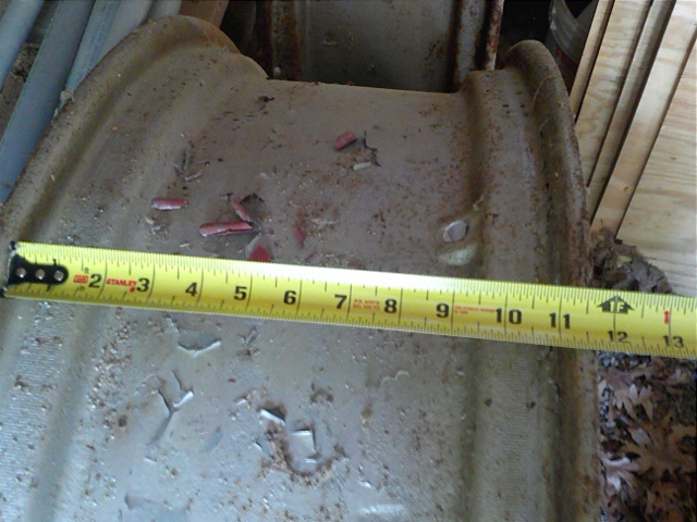

I have a 1961 D-15 Hi-crop tractor (s/n: 3801). I am getting ready to purchase new 12.4-38 tires for my 38x11" rims (see photo). These are not the current wheels on my tractor.
I'm trying to determine if I need to purchase tubeless or tubed tires. Are these rims compatible with tubeless tires? I'd prefer to go tubeless if possible.

If your rims are solid and not rust pitted from being fluid fill tubeless tires will work without problems. Give your rums a good close look after sandblasting before you repaint them and spot weld any holes that might appear.

check the hole size where the valve goes... Make sure you get a valve that FITS.. or you might have to drill the hole alittlel bigger..

While some get away with mounting tubeless tires on rims designed for tube tire, it is not correct.  The rims in your picture are for tube type tires.  The bead seating area is different on rims designed for tubeless tires.
I agree with DrAllis on using radial tubes whether the tire is radial or bias.
Make sure you have the tube "right side up" when you install it.  The stems are offset and can/will rip out of the tube if installed wrong.
This is what I was waiting for. Since my rims are for tube-type tires, that answers the question definitively. Tubes it is. I'll be sure to use radial tubes as well.
