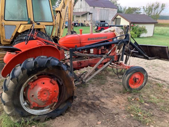

Based on the serial numbers on block and by shifter - can anyone tell me the age?
Points: 22827
Post Options Post Options   Thanks (0) Thanks(0)   Quote DrAllis Quote  Post ReplyReply Direct Link To This Post Posted: 15 Sep 2021 at 10:22am

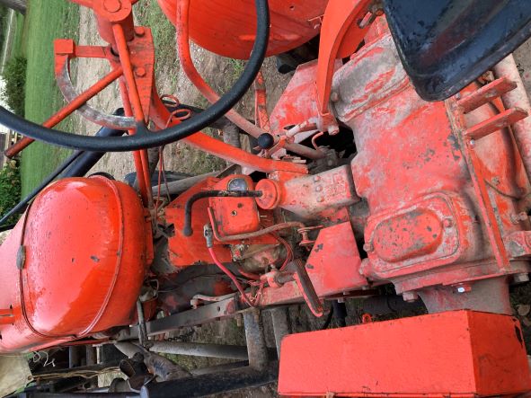

Based on the curved gearshift, it is either a later 1952 WD or as new as a 1957 WD-45. The serial number for the chassis is directly above the left side square headed bolt just above the rockshaft on the rear face of the rear end housing. It is stamped and will say WD XXXXXX. The number you have provided is a raised "casting" number and really means nothing to me. The serial number for the engine is also stamped and is directly behind the hose that runs from the air cleaner to the carburetor. It will say W-xxxxxx for a WD engine or 45-xxxxxx for a WD-45 engine.

What happened to throttle quadrant?

Tall head on a WD makes it a 1951 or newer if original.

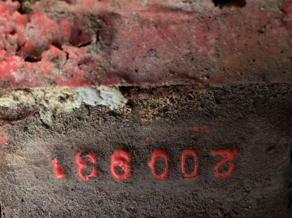

The Block serial is WD 35448 4PA  The 4PA is raised slightly from the others
Points: 22827
Post Options Post Options   Thanks (0) Thanks(0)   Quote DrAllis Quote  Post ReplyReply Direct Link To This Post Posted: 15 Sep 2021 at 8:13pm
So, it's a late 1952 or up to mid 1953 WD. It is not a WD-45 unless you give me the chassis S/N.

I can barely see some of the serial number on the rear differential exactly where it was described to be, but there is too much paint to make it out.  Any thoughts on best way to remove the paint without messing it up too much?

If the manufactured year of the rear is that important to you and have any access to a black light, wipe clean the area good with alcohol. The uncleaned depths in the stamping will become visible with the UV bulb in a very dark setting. Please remember that motor swaps were very common due to interchangeability for these tractors. End of the day— curved shifter indicates late wd though 45 time period trans. Tall head and no engine plate, most likely a 226, can be checked with wire in spark plug hole for stroke verification..

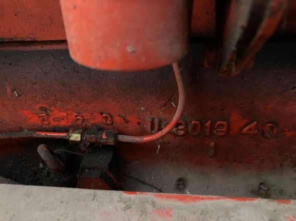

I'm trying to date my tractor. The only numbers I'm seeing are WD 245030 and WD 40246.
dfwallis View Drop Down
Joined: 09 Mar 2023
Location: DFW
Points: 947
Post Options Post Options   Thanks (0) Thanks(0)   Quote dfwallis Quote  Post ReplyReply Direct Link To This Post Posted: 26 May 2024 at 2:48pm
WD40246 is 1950
WD245030 is 1957
