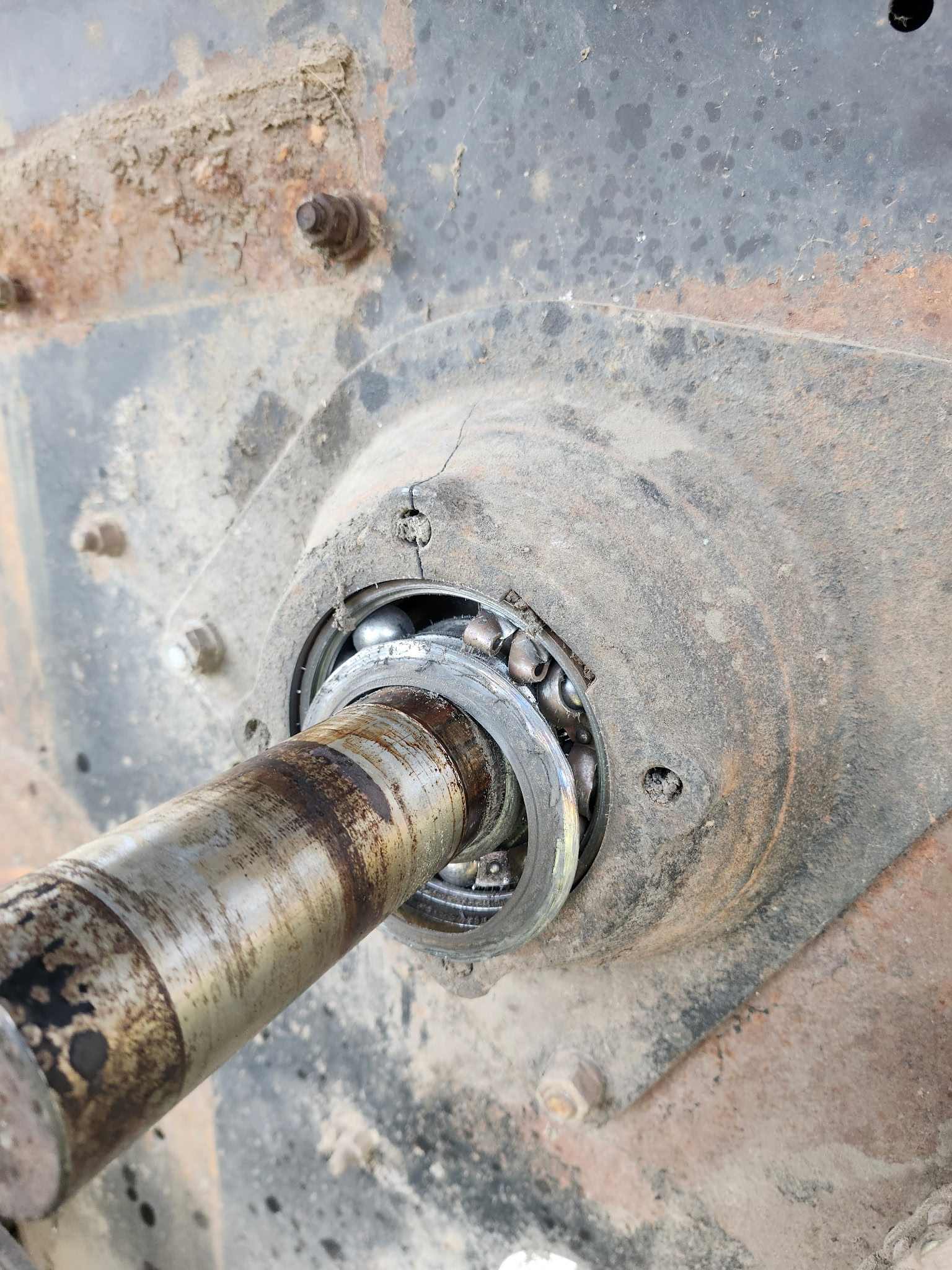

Chunked a bearing on the main shaft and I see the bearing housing is cracked
Is there a trick to removing these pulleys?

My assumption is after removing three bolts off the main pulley, it would just pop loose. The 3 jaw puller has a lot tension at the moment. Figured I could heat near the center if that's all it takes then tackle the clutch. I know a guy near Preston, may have bearing housing

Screw the 5/16s bolts that you took out into the other holes and it will push off quite easily. Blow the holes out first, plenty of lube, and alternate the tension.

Kinda wondered if that was case. I did try that but bolts didn't seem to do anything. I'll clean it out good and try again. Thanks

So this morning we went back and blasted some air into all the holes and sure enough there were threads to engage in as Lynn had stated. Lube and sent the bolts in. Got really really tight. My thread chasers aren't long enough reach in and I thought they were bottomed anyway. Mind you the 3 jaw is still in place. Next I brought out the torch and gave it 3 heat cycles. Went and picked up walnuts for while allowing it to cool. Began the tightening sequence again along with the 3 jaw and all were really tight again then noticed one bolt turning more than the others when POP!! The whole works jumped off and hit the ground. This is a tapered hub and bushing assembly. On closer inspection, two bolts never passed through .the hub. The threads were not clean enough. Now down the inner hub and need a different puller.

Busted housing and outer race pried off easy enough but that inner race pushed my buttons. Hot wrench finished it. Against my wishes we proceeded to remove like assembly from another M3 we have. Knowing what we know now, not nearly as much effort to remove. Currently at the main bearing and good housing. Building a different puller to use the threaded holes in the housing to pull. Family stopped by for visit so we got squirreled. Will resume tomorrow
