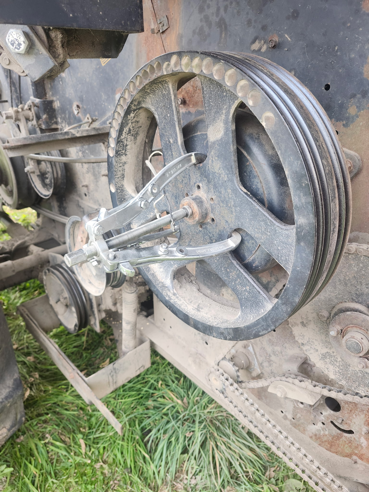

Chunked a bearing on the main shaft and I see the bearing housing is cracked
Is there a trick to removing these pulleys?

Ive got a L3 that looks just like that and ive had that pulley off to put bearings on the main shaft. I didnt have any problem getting it off. If you decide to use heat id be very careful with it. I dont know how much heat the laminations in that header clutch coil will stand
Good luck

My assumption is after removing three bolts off the main pulley, it would just pop loose. The 3 jaw puller has a lot tension at the moment. Figured I could heat near the center if that's all it takes then tackle the clutch. I know a guy near Preston, may have bearing housing
