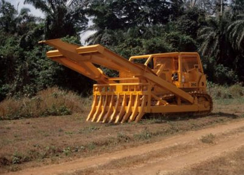

Found this photo on the 'net-

That looks pretty handy- sure would be nice to work on fence rows!

What do you mean the front idler is shot?? I just changed it 100 yards back!

Some of the boys down under have those pushers on their machines . Look like a good idea IF someone does a lot of land clearing .

That gives a new meaning to the name "push beam".  Never seen one like that, but should keep the tall ones from falling back into the hood and roof.

Called leverage - higher up you push from root ball, less digging one has to do .

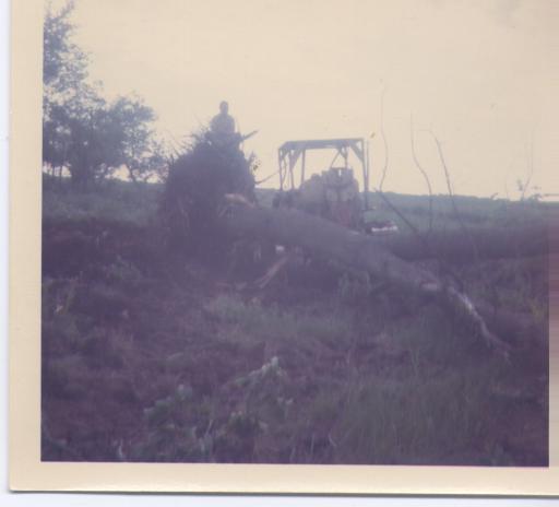

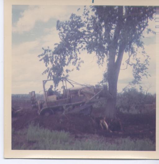

Found these old family photos of another method to push bigger trees.  Sorry it's not an Allis Chalmers...
Lazyts View Drop Down
Joined: 05 Feb 2012
Location: Manitoba
Points: 632
Post Options Post Options   Thanks (0) Thanks(0)   Quote Lazyts Quote  Post ReplyReply Direct Link To This Post Posted: 10 Jan 2014 at 9:19pm
That's my dad sitting on the tree stump in the previous post.

Grandpa had a small dozer in the 1950's. Dad said that was how they had to push lots of the trees when they were clearing - Push up a dirt pile to get leverage.
Couple of years ago (before I got the HD11), we were cleaning up some small bush spots with an ag 4WD (JD9300 w/ 14' blade). Employee had pushed the day before and left one big tree in the middle - said the tractor wouldn't push it over. I went over and dug some dirt from the south side of the tree, pushed it around to the north side and climbed up the new ramp to gain leverage. Pushed the tree over no problem. He just stood there with a stunned look on his face!!!!
