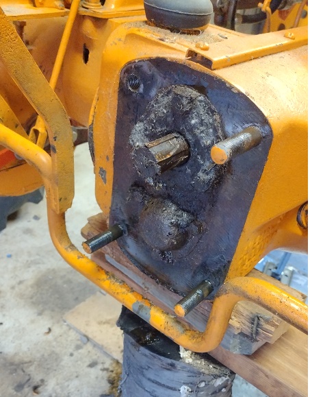

Thanks for that info!  Saved me from making it worse.  The replacement trans main shaft is from a model C that is older, very minimal wear, not like mine at all.
I did not expect to see this when I took the torque tube off.  The shape of the wear pattern makes me think that it was jamming the clutch shaft into the back of the crank when the tractor was under load.
