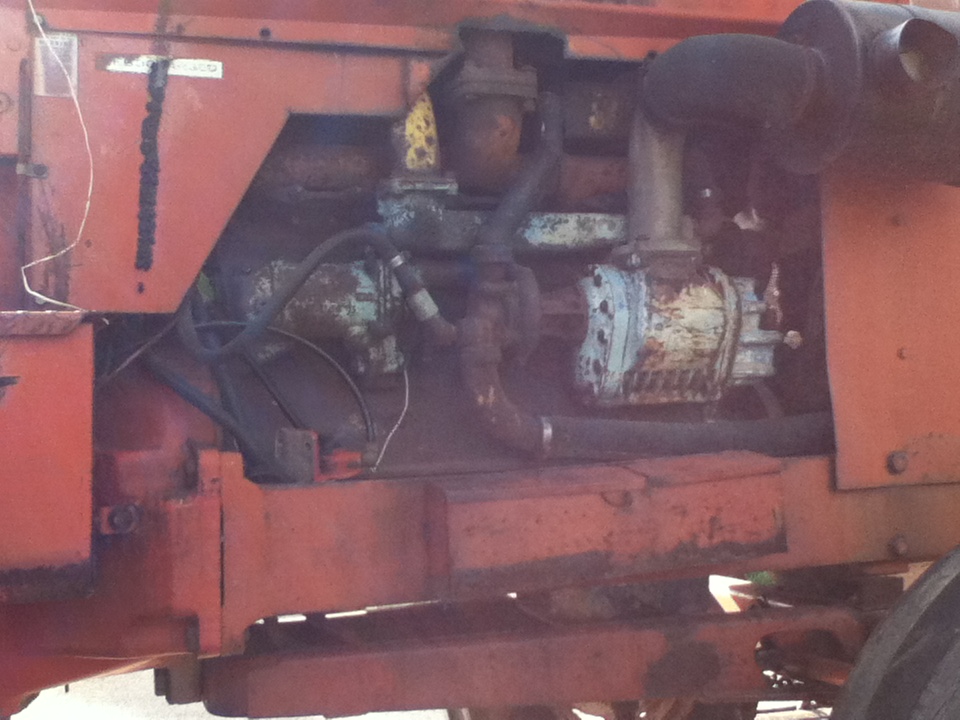

pics of d21from min. with detroit

Wow ingenuity got the hyd pump on there! Nice tractor tho

Originally posted by 7040 7040 wrote:
Well, I'm not sure what engine that is, but I am sure it's not a 6-71, or any 2 cycle Detroit. Thinking it may be a 516 AC/Buda that was supercharged. Just noticed, it is also turbo-charged too. A 2 cycle detroit is not supercharged, the blower simply performs the scavenging/purging. I think I would try keeping that engine in there and restoring that way, if they did a nice job with it at least. That may hold some real historical value!

my dad also believes it to be a series one because of the 6 bolt hubs I will post serialnumber at a later date but neither of us were sure if any series ones were turbocharged we had one that wasn't also I will
look again for any# on motor injpump says Cummings on it alternator bracket says white motor is stuck oilpan is cracked (cast alum)it wont be scraped without being opend up
There was some supercharged Cummins engines in those days too. post some close up pics of the other side too. All series I are non turbo originally, series II were all turbo, that is the difference. Lots of the series I were converted to turbo, there was a kit available from AC.

Ed I think that is an old inline two cycle. And I dont see a turbine. The thing on the back of the supercharger is the water pump. There were Detroits made with blowers and turbos, they were the Silver series. They used a blower to charge and scavenge, and a turbo to "pack" the blower. I had a V-6 92 Silver rated at 350 hp, and it pulled more like a four cycle with that set-up, plus it helped the milage. It was in the first series of computers, called D-dact, I think, and were a PIA when the 'puter sensed wierd stuff. It would shut the truck down, or idle it, usually when you needed power. Mine was famous for throwing a low water lite and cutting power when it got a quart or two low on water. Never did find out where the water went.
Prior to this series, with the old "71" series, there were both V-8's and 6's made with blowers and trubos. I think back in the fifties/early sixties. Dont remember the V-8 hp, but I think the six was a 305 hp engine. They didn't make them too long, but I don't know why.

detroits dont have injection pumps

Well, if I dare chime in on this one.  We have a detroit inline 6 out of a concrete truck, from maybe the 70s sitting at the farm.  While I cannot remember if it is the same as this engine, it looks similar.  I do agree however that it does look like a cummings injection pump on the back of the air compressor.  I will take a look at the Detroit we have on the farm in a couple of months.
oh, I'm full aware that there were 2 cycle Detroits with turbos as well as the blower. I'm saying that is NOT a detroit. Yes, you are right, after looking more at the pics, the exh pipe is bolted to the exhaust manifold like a turbo, but it's a straight shot up, so I think it's just the pipe. The dead giveaway for me is the intake manifold. The blower bolts right to the center of the block on all the inline 2-cycle jimmy's. That supercharger is an accessory to that engine, not part of it like a jimmy as well.

It is not d-dact,it is ddec. It stands for Detroit Diesel Electronic Control. It sure looks like I supercharged cummins to me. Inline detroits had the blower more tothe center of the block, I don't see the air box covers, and most detroits were rear gear train, meaning the compressor would be on the back of the motor

It's a Cummins, do not recall the model, we had one on the truck side of an American Hoist truck crane at work, mid 60's vintage, never seen another till here.

NHS I do believe is the model

stole this from the net...
1952 Cummins Op & Maintenance manual (Bulletin No. 63333-B) lists (and provides pics of) the following supercharged engines:
  • HS-600: 672ci, 14:1 CR, 200hp @ 1800;
  • HRS-600: 743ci, 13.5:1 CR, 225hp @ 1800;
  • NHS-600: 743ci, 13.5:1 CR, 275hp @ 2100; and
  • NHRS-600: 743ci, 12:1 CR, 300hp @ 2100.
All of the above have geartrain driven superchargers. H denotes 2 valves per cyl., NH 4 (no "B", of course). The supercharger casings are different from the belt driven one ##### posted, for what it's worth. Also - and I'm quite happy to be corrected on this - I think the blocks had high Nickel content on them.

Thanks Don and Cal. I haven't been around a two cycle(except for the 6 V-92 in my 87 GMC General) since the late 70- early 80's and that's a long time for my short term memory. I do remember the JT 150 Cummins( I think I'm right) that I had in the Army as generator power with superchargers. But I think they had a "rail" system of sending fuel to the block instead of individual lines. And that was prior to discharge on Feb. 1965.

Looks to me like a regular Cummins 'PT' [Pressure Time] system. Actually a little similar to newer 'common rail' in newer engines. In the PT system, the rail pressure varied and changed the amount that the injectors put into the cylinders. One injector per cylinder, driven off the camshaft and sits between the valves. Worked pretty well for many years.

At the time I had an inline 6-71 Detroit, I had a 220 Cummins with PT injection(I think). There was a supply pump as Tram said, and it contained the govenor and "rack". By opening up the pump, you could place extra shims under a spring, and there was a "button"( it really looked more like a tick thimble) that could be replaced. This supplied extra fuel/and or pressure which increased the horsepower(and smoke factor and fire out of the pipe). I wound up with something like 2400 rpm's and about a foot and a half of flame, but it certainly pulled harder. This was in the days when if you ran over roadkill, or it rained, (seriously, a wet road we considered cost up to 10-15 hp)you had to drop a gear!
On the Detroits, the injectors came in differing calibrations and by changing the settings when adjusting them to the camshaft stroke, they could be made much more responsive and gain some extra power from the factory settings.
The 220, maybe an NTC? designation had three cylinder heads if I remember right, and the picture only has one I think.
