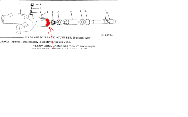

Left side track has popped off 3 times in this 60-70 hrs of use.  It is currently off and I am attempting to get it back on but this is the first time it has came completely off the front idler and part of the lower rollers.  I have released the tension on the hydraulic adjusters and found the adjuster rod was not seated in the spring pocket and the rod does not want to line up with the pocket. It is about an inch below and to the side of the pocket.   I haven't had a lot of time to work on it yet as I only have 30 minutes to an hour each evening before dark to work on it after work.   Also as my rails are worn and stretched out and my idler is almost all the way out  but when I went to release the tension I found the adjuster housing was hitting the cross brace and appeared to be fully retracted and bottomed out.  The rod will retract further inside the adjuster but as it is not touching the pocket  and the adjuster appears bottomed out against the frame bracing this does not help.  In diagram below the area in red on the adjuster is hitting the outside of the box welded on the frame that the adjuster rod goes into before entering the spring pocket.  It doesn't seem correct to me as I would think the frame/adjuster would have more than the 1-2 inches adjustment before pushing the idler off the end of the frame.

My question about the adjuster hitting the frame is more for when I put my new rails on that are much tighter.  Currently it appears I can only move my front idlers back 2-3 inches total from the end of the frame before the adjuster housing marked in red on the dwg above bottoms out in the holder welded to the frame.  Is this normal as I was thinking It should have alot more adjustment.

Remember that few inches of movement is double the amount , so 3" of movement is equal to 6" of take up on the track.  That would be like a full link of the chain. Remember a 1/8" of wear in each pin and bushing X 39 links = 4.875 of wear for full track = 2.375 or so movement of the front idler.
 So a little wear compounds but a small adjustment takes up a lot of slack .

If your hydraulic track adjuster is at maximum extension and your track is still too loose you can put spacers between the idler bracket and the yoke. You can also use this trick if the idler is out of alignment. This will allow you to use the machine until you have time to fix it correctly.

Thanks for all the help and ideas so far.  My adjusters will tension the track but bleed down in 5-10 minutes as the seals are bad.  I have the seals already just trying to get the work done before I pull the undercarriage apart and fix it all at the same time.  I did find my left idler not running true with the frame.  This appears to be caused by the adjuster holding it as the adjuster rod is not in line with the pocket.  I have cleaned everything out and got everything freed up and added a shim between the idler and adjuster on the inside.  I am also going to make a couple more shims to put between the idler and adjuster on both sides to tighten the chain up.  Hoping to have it all done by the weekend so I can get the road and building site finished up.  Also I want to try out the new teeth and adapters I am in the middle of welding onto my bucket hoping they will make it a little easier to cut down the high spots and dig in the hard MO clay we have.
