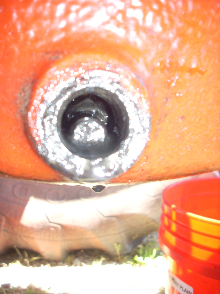

    Posted: 01 Jul 2012 at 4:25am
final drive drain hole. Rather than tear down sooo much to get this bolt out, I may drill out threads using a 7/8 in drill, remove bolt and rethread with 15/16. It's a chewed up 1/2 in hex cap screw an inch long. Hex head will easily exit a 7/8 in hole. Using a powerful magnet there doesn't seem to be enough clearance to get this past final drive gear. Should I drill and tap? I think so. I'm afraid of setting a fire if I try and torch the head off through the hole. Thanks, Dana

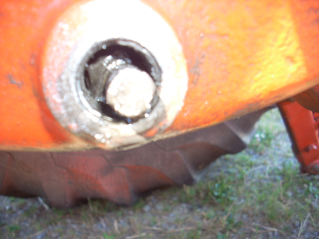

Ok guys and Doc. I rechecked the carrier bolts from within the rear end. There are 6 half in diameter bolts. Many days ago when I first pulled the rear pto housing I checked those 6 bolts and they're all there. I just checked again and yes they are there. I will pull the brake housing and see what else I can find. I have assumed that once upon a time one of those 6 bolts came out and that is the bolt lying below my bull gear. I assumed someone replaced that bolt 'cause they're all in there. And I also assume they said "the heck with that bolt, I ain't gonna take all that apart to get it, it can just stay there". But what I can NOT understand is why they didn't seal the crack in the bull housing that caused all the oil except a half gallon to run out. But...I shouldn't keep assuming! OK, I'm off to pull the brakes.

Post Options Post Options   Thanks (0) Thanks(0)   Quote captaindana Quote  Post ReplyReply Direct Link To This Post Posted: 01 Jul 2012 at 1:56pm
Gerald that is a good idea. I removed brakes and housing. The housing won't clear the platform so I bungied it up out of my way. I inspected bolts and all gears in there while turning the gears via a socket on inside axle bearing retaining bolt. I can see 4 of the carrier bolts and I can feel the other 2 behind the bull. All seem in order, however I noticed those carrier bolts seem black and appear to be grade 8's. The rascal in the bottom doesn't appear to be one from that family. And I see no other bolts that could have fallen from above. Remember my trans oil was yellow when I drained it last week because it was not flushed correctly last fall and water was still in there. The axle leaking oil was new final drive oil. It was not yellow so I don't think trans oil was getting into the final. So as of now I need lots of oring seals, gaskets, bearings and races and LUCK. Oh yeah and now I need some replacement brake bands and disc material and springs and ugh...As for the inner axle bearing it seems fine. Onve I install new outer brg i can tell for sure. Pinion and bull teeth look unscathed. And the beat goes on. Thanks everyone. Oh yeah, I still gotta get that bolt out!

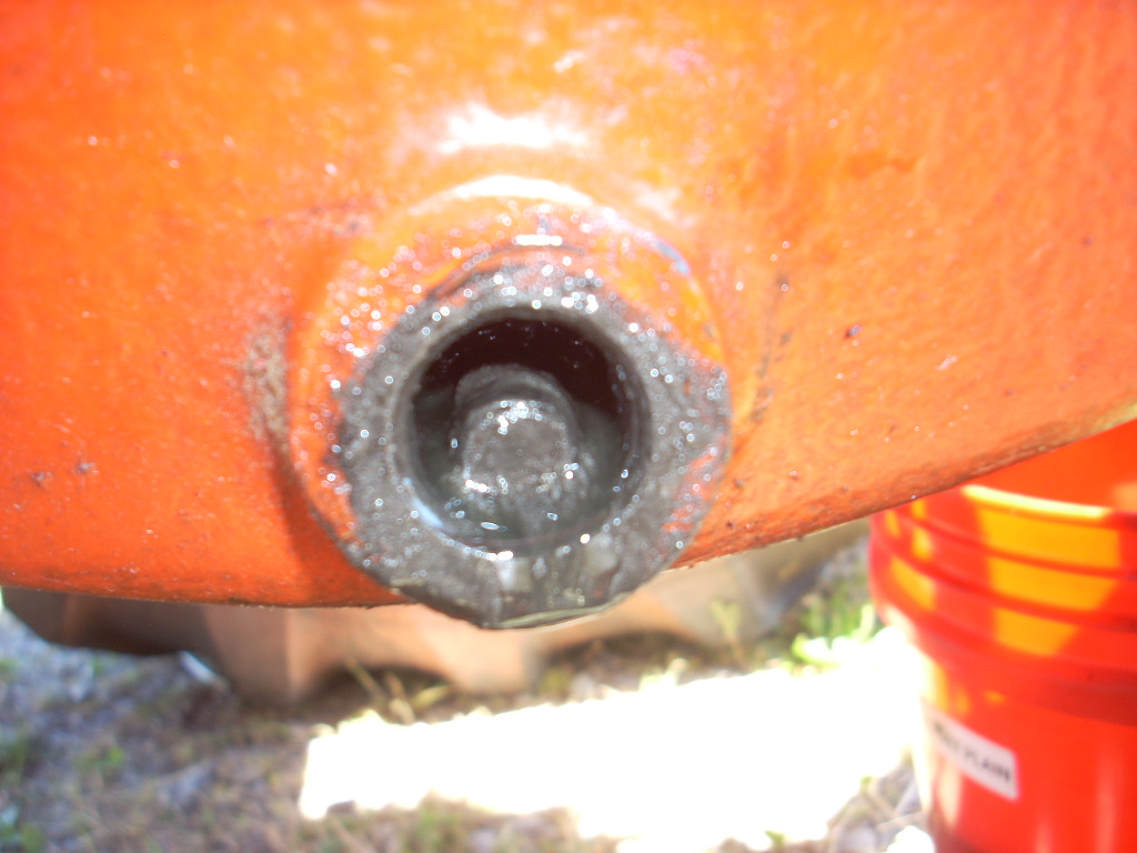

Post Options Post Options   Thanks (0) Thanks(0)   Quote captaindana Quote  Post ReplyReply Direct Link To This Post Posted: 02 Jul 2012 at 5:23am
Good morning y'all. I pulled the axle sleeve days ago. My first few hours fishing was with my trusty flat cow magnet taped to a length of flexible green car wiring. Next try was with a powerful telescoping button magnet which I bent 90* and also taped wire to it so I didn't loose it! You know what I do have going for me? With the outer ax brg off I can lift and lower outside ax end a little which tips and tilts bull gear. Last year I locked my keys in my Camry twice and triple A got em each time no problemmo, I should call them lol. Also I could NOT find my flex shaft thing a ma jig grabbing tool...I need to try these options. I really like the idea of catching on the bull for a 'ferris wheel' ride to the top. After all that's how it got there. My biggest issue is getting a third or fourth helping hand! Thanks guys. CaptainDana
