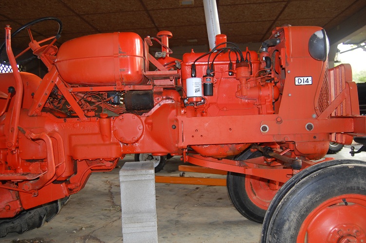

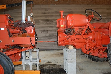

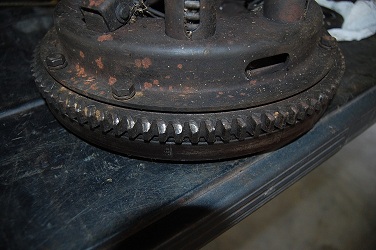

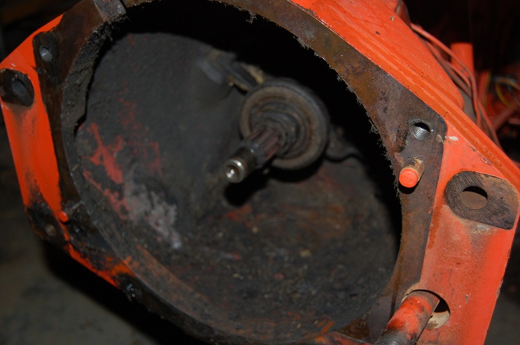

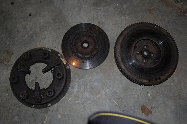

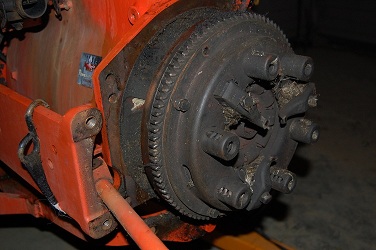

A few weeks ago I borrowed a timing light to check my D14 during a tuneup.  I was unable to see the mark on the flywheel with the light.  I split the tractor yesterday to take the clutch out and did see the marks on the flywheel.  I turned the flywheel to the approximate location for the timing hole.  My rotary button was on the number four post.  I did not see a key way for the flywheel.  I only had 4 bolts holding the flywheel and I think I could mount it where ever I wanted.  Could someone have been in the tractor before and not lined the marks with the distributor?  I will make sure when I put it back together to get the number one piston on TDC and then put on the flywheel to get the marks in the right position.  I would have thought the flywheel could only be put on in one position.

NO, you can't put the flywheel on wrong, if you look really closely the bolt hole are not exactly the same distance apart.  If you put the flywheel up there and just happen to hit the correct position congratulations.  As to why your timing isn't correct, I don't know if I read what you were trying to say correctly, but your timing light trigger needs to be on the Number 1 cylinder wire, the front one.

Also I'd rather you not use concrete blocks ,unless solids, or at least put them 'regular' way down not the way in the picture. Maybe I'm getting fussy about safety the older I get but blocks do not have a lot of strength the way you've got them.I used 10by10 timbers and 1by8 'shims'.Odds are you won't get hurt or be pinned under the tractor when the block fails by ,but will break a leg or gash something or run into a rather solid steel workbench(don't ask...)when you 'jack rabbit' away from the 'accident'.

Looks like you had a nice 'mouse house' in the bell housing . Also check the ring gear and be sure all the teeth are good.It's a lot easier to do it all NOW instead of later...(yup, me did that too !!)

Second what Jay says about the concrete blocks. The way you have them stacked is inviting a catastrophic failure. They only have compression strength when stacked in the "normal" direction. But I had rather not use them at all. Heavy wood blocks are much safer. Not being nitpicking, just don't want an accident happening when it can be prevented.

Thanks for the advice. I will try to borrow some wood blocks from a local truck shop.
