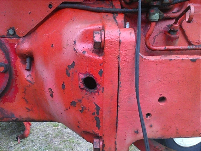

3) When setting the timing, the manual references a "hole in the torque tube". Is the photo below this hole??! It says to adjust @ 1750RPM until I see a "F-25" centered in the hole.

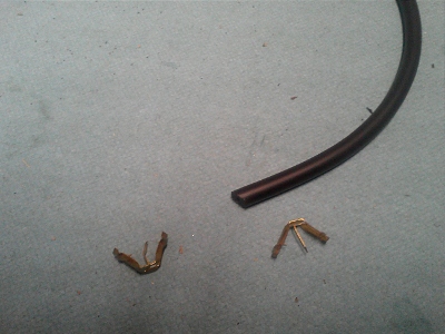

4) And one more thing...while I have built custom spark plug wires before the distributor end has already been factory crimped. With this kit (given to me by previous owner) I have has these little brass colored devices, as shown in second photo. I assume I'm supposed to pierce the plug wire along the conductor and sink it in? When I try to do so, the thing bends (left one in pic) because it's so thin.

Yes you are correct on the hole location.
I hate those plug wires you are trying to use, but what you are doing is the right idea. They have to push in the center of the wire to contact the wire well, then the distributor cap holds them up against the wire.  I think you will find that those won't attach to your plugs, those are the dist. end, not the plug end, so you are probably better off buying a better set anyway.

BTW, it looks like you need to address the clutch pivot soon, before you loose the pin all together.  At the back of the bell housing, do you see the ~3/16" pin with a groove machined into it sticking out of the housing about an 1" or so.  That should be pushed in flush, and a keeper pin, on the inside of the housing.  I am not sure you can fix that without a split, since the inspection holes on these things are so small.  Anyway, I would get that fixed soon, if it fall out, your clutch won't work right, and it could catch on the pressure plate springs and tear something up.

Before crimping those terminals in that kit, strip off 3/8" of insulation and bend the bared wire back over the insulation, you'll get better contact.

The pivot pin can be fixed safely without a split. Will not be correct, but will work till clutch time. Need a rod same diameter longer in length. From the top is the way to pin  it. Needs to be long enough to taper- chamfer the entrance end and a cotter pin hole below chamfer , other end needs cotter pin hole also. Start the pin from side you have in picture. Chamfer first with pin hole behind chamfer. Your pin will have to be much longer than it is now. When pin is thru the torque tube, you will have a cotter pin on top of torque tube, and one for the side showing. It will keep the pin from working out. The same as the clip was meant to do. Clip shoud have been towards top to be correct.Throw them wires away and get a set from Steve at B&B Circuits, you will be happier.  HTH Tracy Martin

Wow, good eye on the clutch pivot pin. Funny thing, when I took that photo, I noticed that pin. Had never gave it a glance before, and wondered what the heck it was. And just as quickly, I forgot about it. Tracy, thanks for the info on the easier fix, I'll get to that as soon as I can.

Was going to use the plug wires that I had, but I'm not happy with how they go together. The plug end is more typical, but the distributor end is junk.

I can't believe that those "universal" spark plug wire sets with those junk terminal ends are still sold out there. Those are the worst for good contact and transfer of current. That's why our custom built wires have crimp terminals on each end, along with an Orange Hy-Heat Silcone boot on the spark plug end if so desired. If you ever have to remove the spark plug wire from the Distributor cap with those terminal ends, in most cases, that end stays behind in the cap and it rips the jacket on the wire. Grim design... very grim....  Thumbs Down
