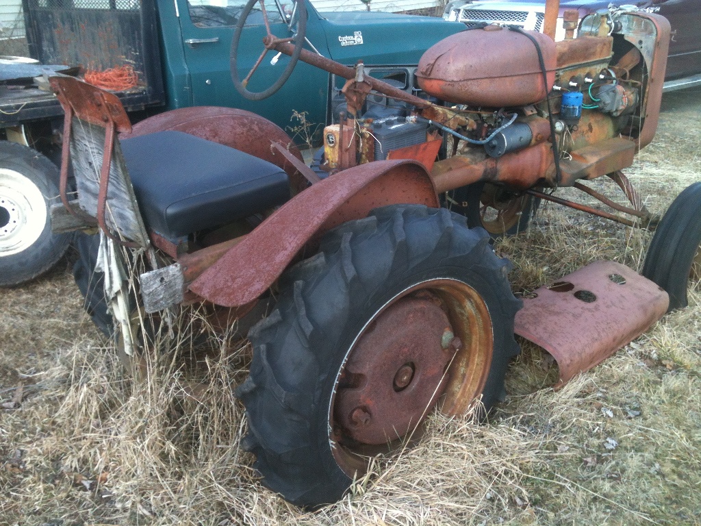

Saved this from being sold by the pound.  Lots of plusses-war tractor, wheel weights, side weights, rebuilt mag, etc

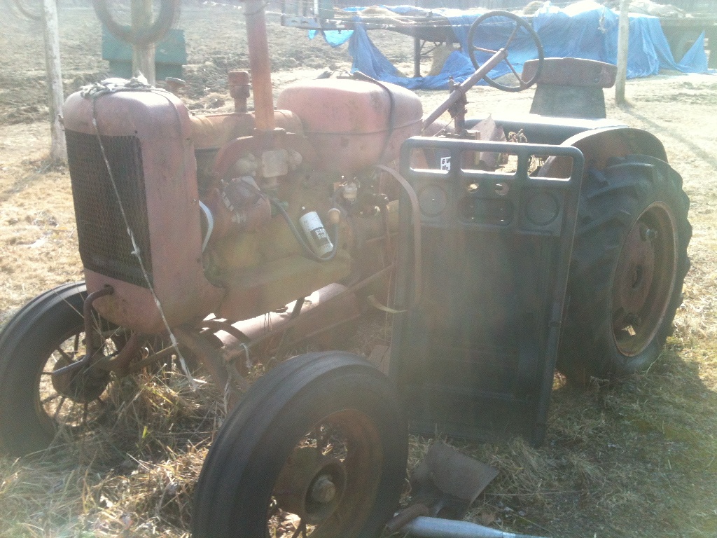

Anybody recognize the front wheels?
Anybody have a reasonably priced set of steel wheels available?

Good save! Looks like she's got the wide fenders and spoke wheels from a war B. Looks like everything's mostly there. Got the SN?

S/N is in notebook up in the shed,  It's a 1943

War tractor means built during WWII.  Many had steel wheels and many normally sheet metal parts were cast iron.  Also no starter, generator etc

Does it have hydraulics, don't see a rock shaft.   Tim

Well, you paid for the frame weights and the front wheels.   Kindly send me your address so I can come and pick up the steel wheel fenders and rear wheel weights from you for free!!  LOL

Chuch:
Do you think those are the right front wheels?
I might know where there is another set of war fenders

Those are the right wheels, just been cut off for rubber.

It does have hydraulics, rockshaft gone

You may want to check the valve cover, the oil pan, and the final drive oil pans.  Some during WWII were made of cast iron due to the shortage of pressed steel.  Looks like this one came through on steel - many did in fact, my job then was to install the cleats - and was converted to rubber when it became available after WWII.
Looks like it is not in bad shape for an almost 80 year old.

Love the fenders, love the weights, love the spoked wheels, love the 6volt, but mostly that it was saved. A great day.

Those were originally steel front wheels. Look where the spoke meets the rim, you'll see weld. The front steel was cut off and rims welded on.

Don't see it in the pic but if the air cleaner was with it it should be taller than a regular one , taller would be correct for steel wheels. Great find!!
