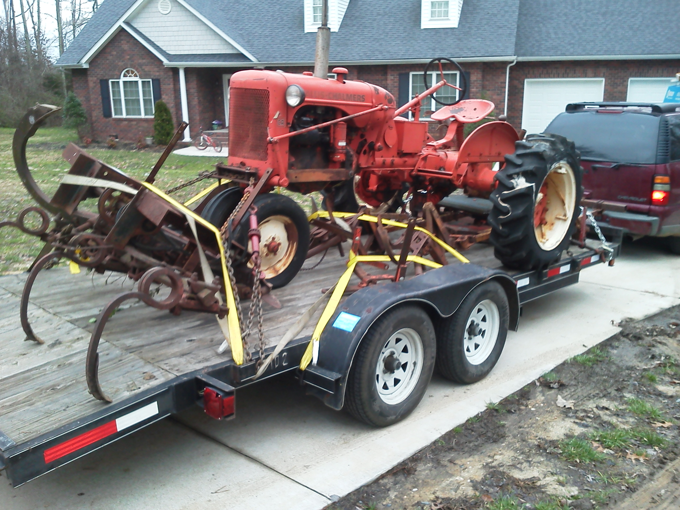

Well the trip was a success. Had a CA and loads of equipment follow me home older restoration with low hours but sat under a chicken coop
Sorry about size, uploading from phone.
By the way, current pricing, $2k
think I did well

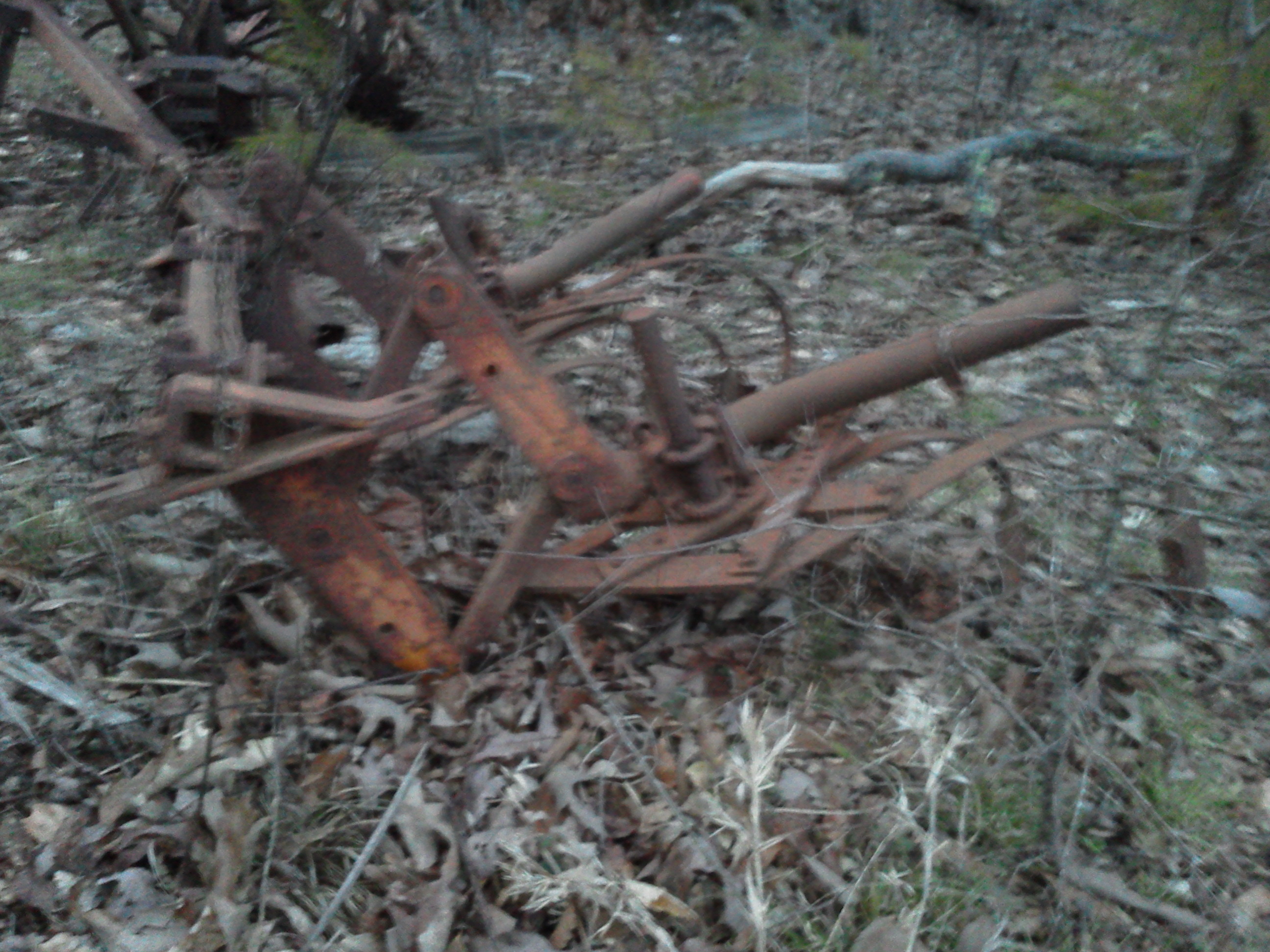

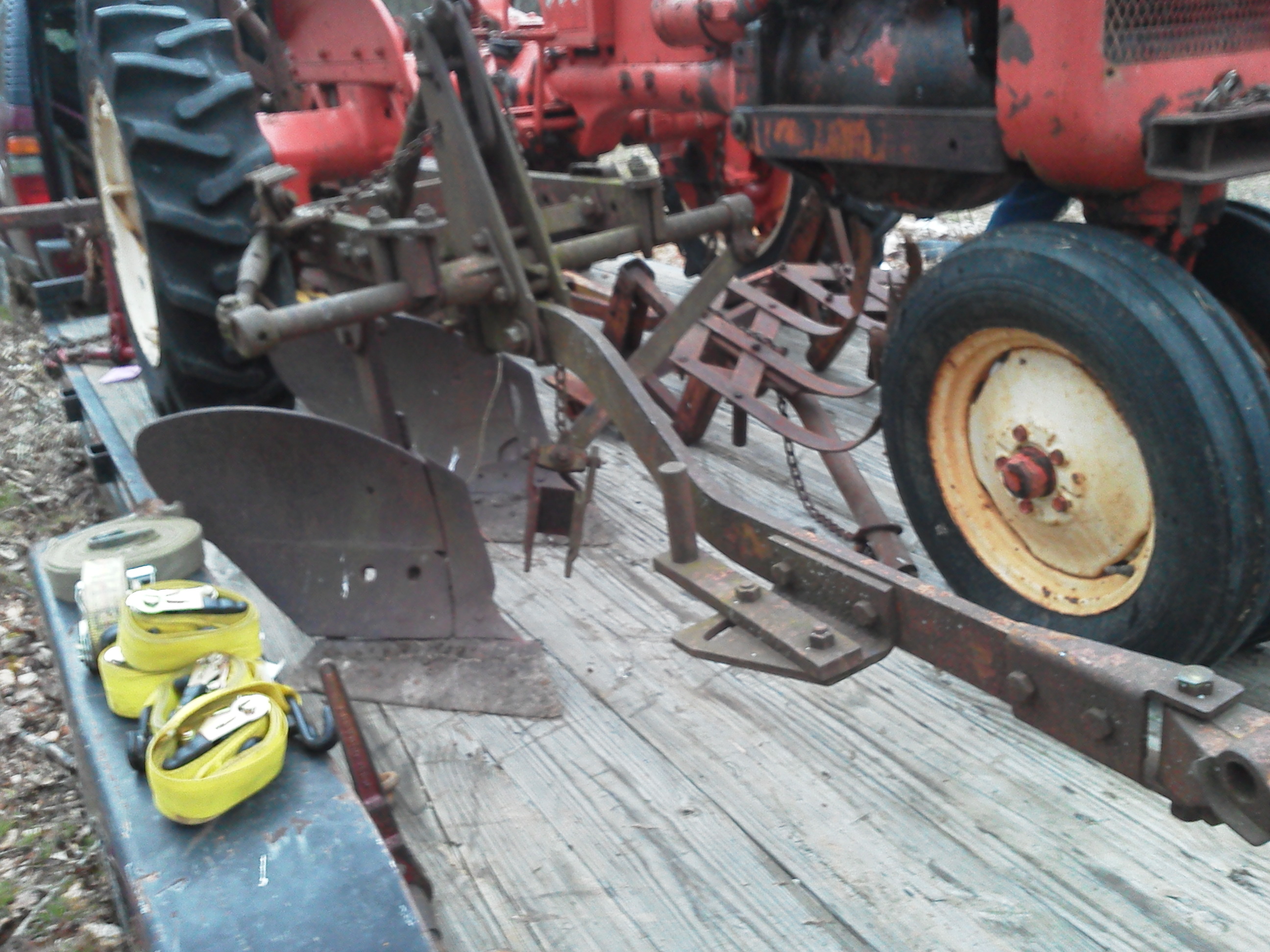

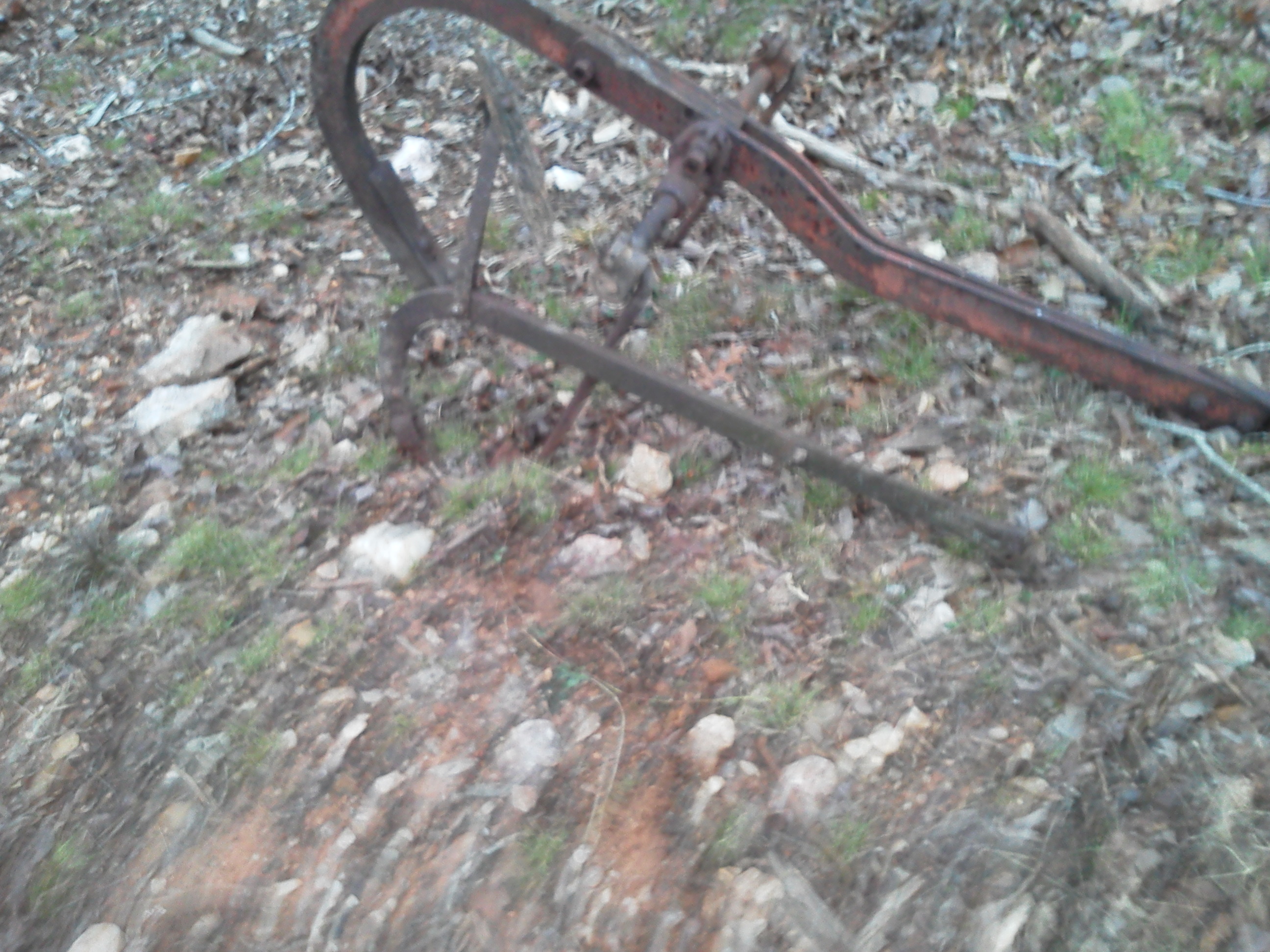

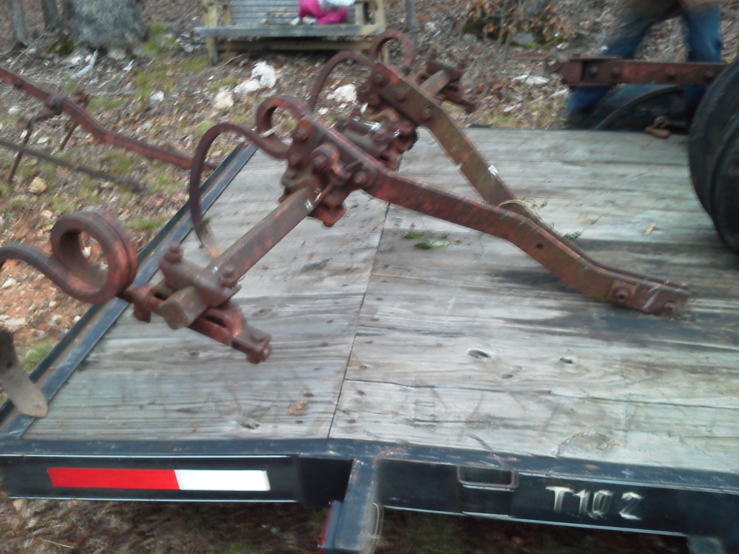

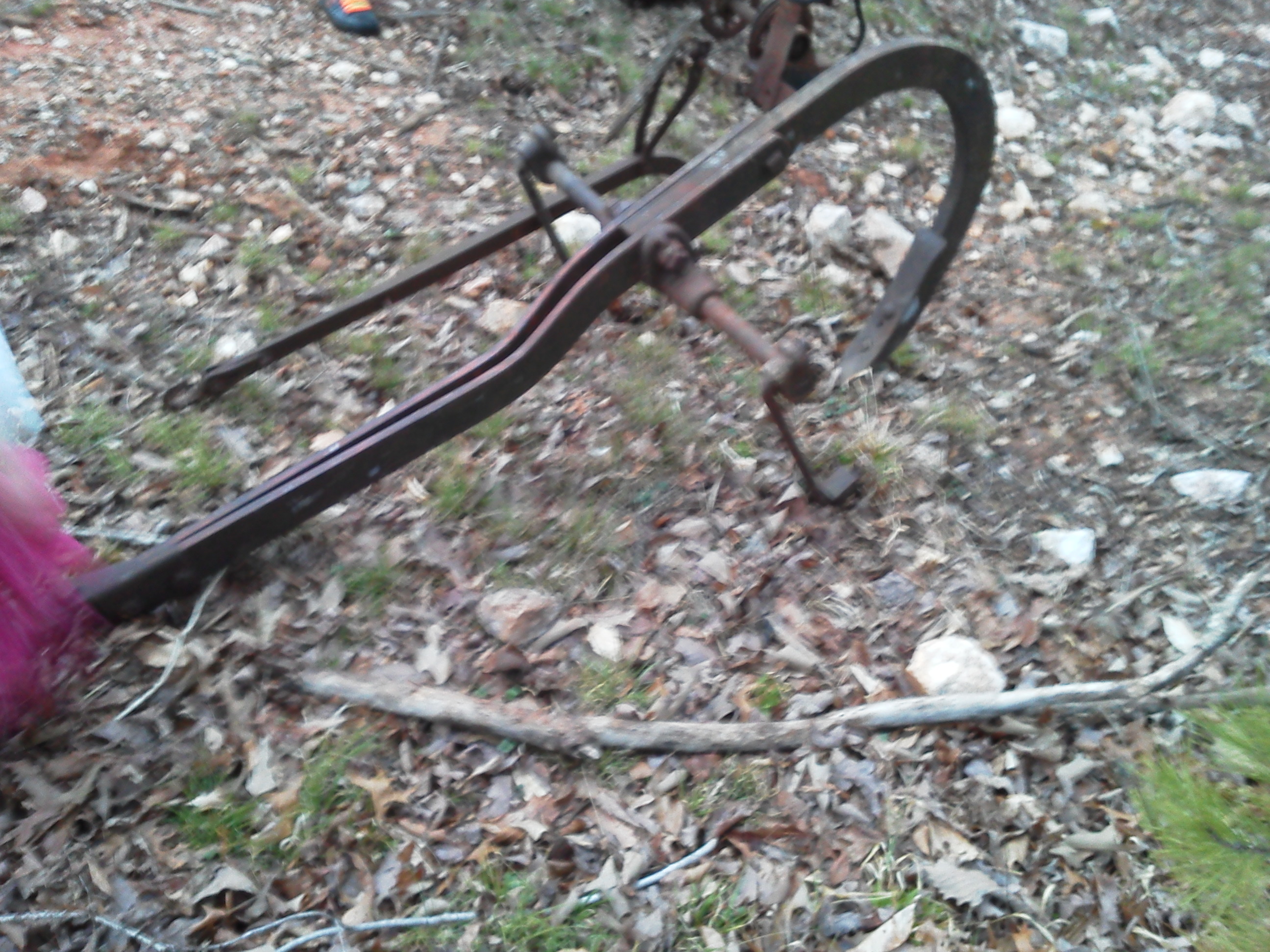

May need help with what all I got.
Got an ih belly mower adapted to fit, a two row plow, cultivators, a single root rake? Spring ripper? Lift handles. And belly tines?

Looks like a good haul. The great big curved thing with a point on the end is a subsoiler.

What's the little one I've leaned against the sub soiler? It has a little snap hook.

I don't see the hand clutch lever. It either didn't come with one or the lever was removed. If it was removed I would guess the hand clutch needs work. Really nice haul you have there.

Looks like a nice haul. The hand clutch lever on yours seems to be missing. It should be a lever about 30 inches long just inside the right fender. It disconnected the right hand axle shaft to stop the tractor but let the pto continue to run. Many times when these would start to slip they would be bolted together and the lever removed. This eliminated the slip but it also eliminated the hand clutch function also.

Nick, what year is she. looks like the later style air cleaner with a pin hitch, might be about 1952 and a half, maybe early 53? Looks like somebody did some heavy lifting to load and unload it all.

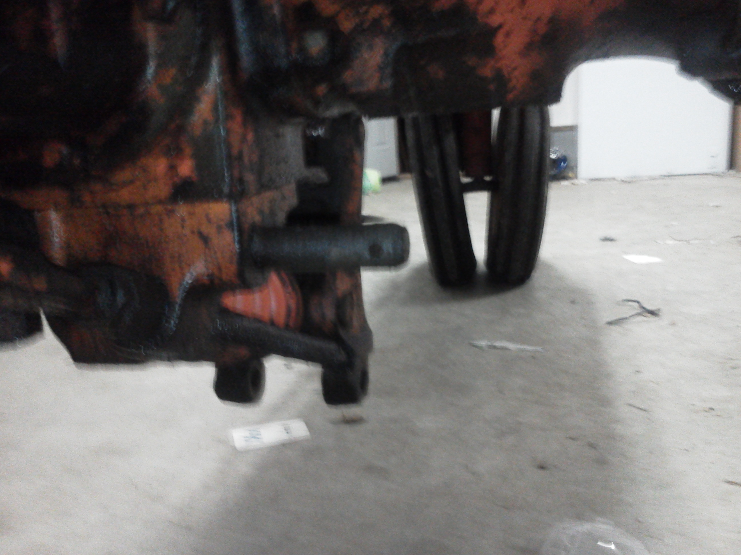

The serial number is CA25065
is this where the hand clutch lever should attach?

CA25065 is an early 53. The hand clutch handle comes out of the right front curved section of the platform. This is kinda far away but to the right of DeWayne's right leg, next to the right fender is the handle.

Yep don't have that lever guess I'll have to find one and figure out if there's an issue. Anybody got one laying around they want to part with?
