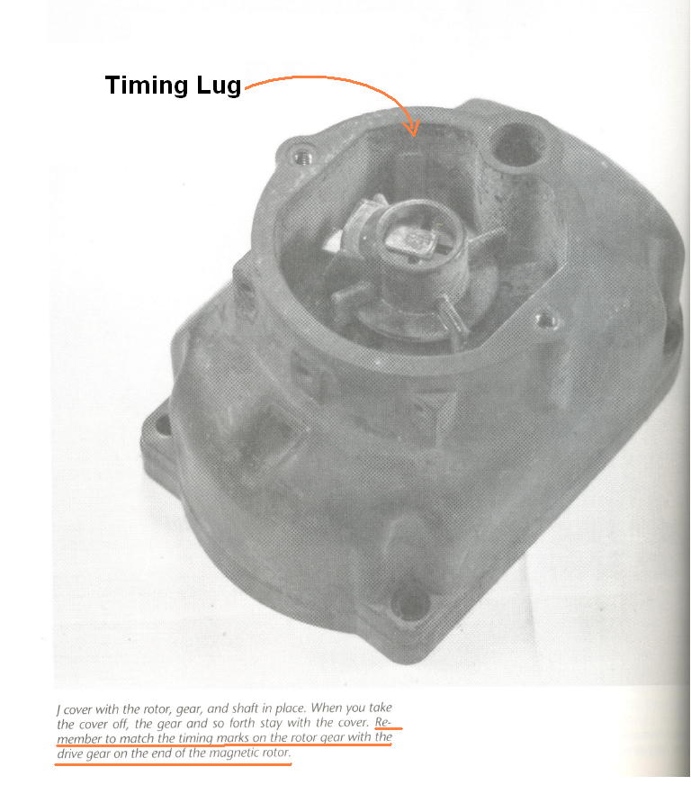

The only other thing I can suggest is to try a couple of different timing settings on the mag.  When you have the fire mark at TDC, check the mag to see that the rotor is at the timing lug in the mag.  One tooth off in the internal gears could do this also.

well, I have a fmk mag. it is a little different than the j. I am not sure what the timing lug is. I'll try swapping out some parts and see what happens.

Post Options Post Options   Thanks (0) Thanks(0)   Quote Dave Richards (WV) Quote  Post ReplyReply Direct Link To This Post Posted: 05 Oct 2011 at 9:47am

yeah, that's the fmj mag. mine is different. I will take a closer look tonight to see if I can see something. thanks for all the help. I want this to run right do bad
