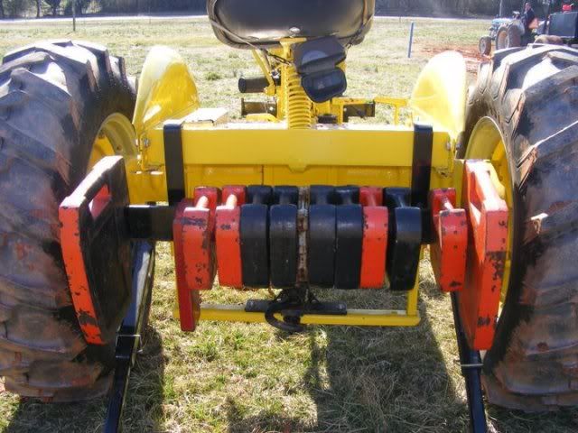

Dick L View Drop Down
Location: Edon Ohio
Points: 5087
Post Options Post Options   Thanks (0) Thanks(0)   Quote Dick L Quote  Post ReplyReply Direct Link To This Post Posted: 27 Jul 2011 at 8:39am
The picture below was taken to show the chicken bars but you can see where I cut off the old drawbar and welded in the straight drawbar so I could hook close to the 18 inches back from the axle center. Served me well over the years I pulled.
Notice the shim blocks over the drawbar at the clevis. I used those to adjust the hook highth.
