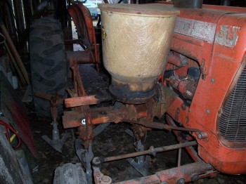

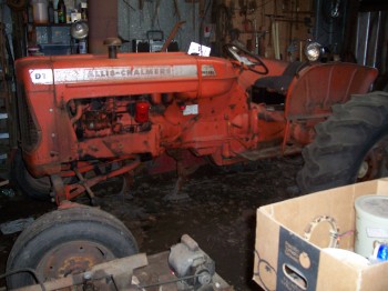

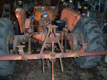

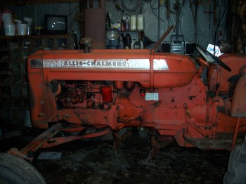

Here's a few pics of the old girl in the shop with her garden gear on.
